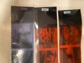

Hey guys,
Just picked up a Mamiya RB67 and put a few rolls through it and got the negatives back. The last frame of the negatives are all cut off by 1-3mm. I was extremely precise in loading to ensure the arrows aligned before winding. I’m assuming the “easy fix” is to not match the arrows up by compensation but then it seems like that would be an awful guessing game. Any ideas on other fixes?

How is the space between frames?
When loading insert the lead of the backing paper through the slot in the take up spool, fold back the opposite direction of the wind action, advance until the incoming paper is over the folded lead holding it in place.
The roll film holder may need a CLA, clean, lube,adjust.
https://learncamerarepair.com/downloads/pdf/mamiya-rb67-pro-s-repair-manual.pdf
The roll film holder starts on page 48. A RB67 Pro will not have all the lockouts found on a Pro S which will not have all the features/lockouts of a Pro SD.
EDIT: How far from the lead edge is the first frame?

It looks like the end was exposed to light which shouldn't happen. The end should be clear, not black. Did you fully wind the film onto the take-up reel before opening the back and make sure that it stayed rolled tight? The films I have used have a paper tab that you lick and stick to keep it from unwinding before developing.

Perhaps the processor fogged the end of the film when loading into their machine. Try developing a roll at home to verify the frame spacing is good and that the camera is not at fault.

You lost the tail of the film to daylight loading fog by your processor. if you load the film in the dark, the entire roll come out unfogged.
A lot of the existing processors use cassette loading, which is meant for daylight loading and the smaller volumes of today, but fogs a short bit of the film when you feed the roll. Unless they can load in the dark, there is nothing they can do, except minimize the length of the fog. I've talked to the operators, and the length of fog can be reduced to about 1/3 of that with good technique, which would get your last frame in.

I'm with itsdoable....
One of the labs I worked in used cassettes for loading 120 film into a roller-transport C-41 processor.
It looks like the tech left too much of the tail out of the cassette, or waited a bit too long before closing the door...(probably verifying that it was moving into the processor.)
The fogging on the end should be much less.

I'll third the opinion that its the lab. Doesn't look like its mechanical to me.
Another good reason to pick up the chems/tools and learn to develop yourself!

Thanks to everyone who responded! I was out of town working, and I came home and the lab was permanently closed so I didn't have a chance to talk to them. I shot another few rolls and sent them off to another lab out of town so we'll see.

I have the lab return 120 film to me cut 3-3-2-2 and slipped into a plastic page that protects the film from dust and scratches. Ask your lab to do that. I've used North Coast Photo in CA, Dwaynes, and LTI Lightside in NYC. They all provide that service, return the film flat and never screwed up the processing. Why does your film have a "Z" bend to them?

Yeah, minilabs don't always have skilled operators. I they leave just a bit out of the cassette, and tape the leader card just right. You won't have any problems with the prolabs that use dip and dunk processors, that's all done in the dark. And no scratches.
