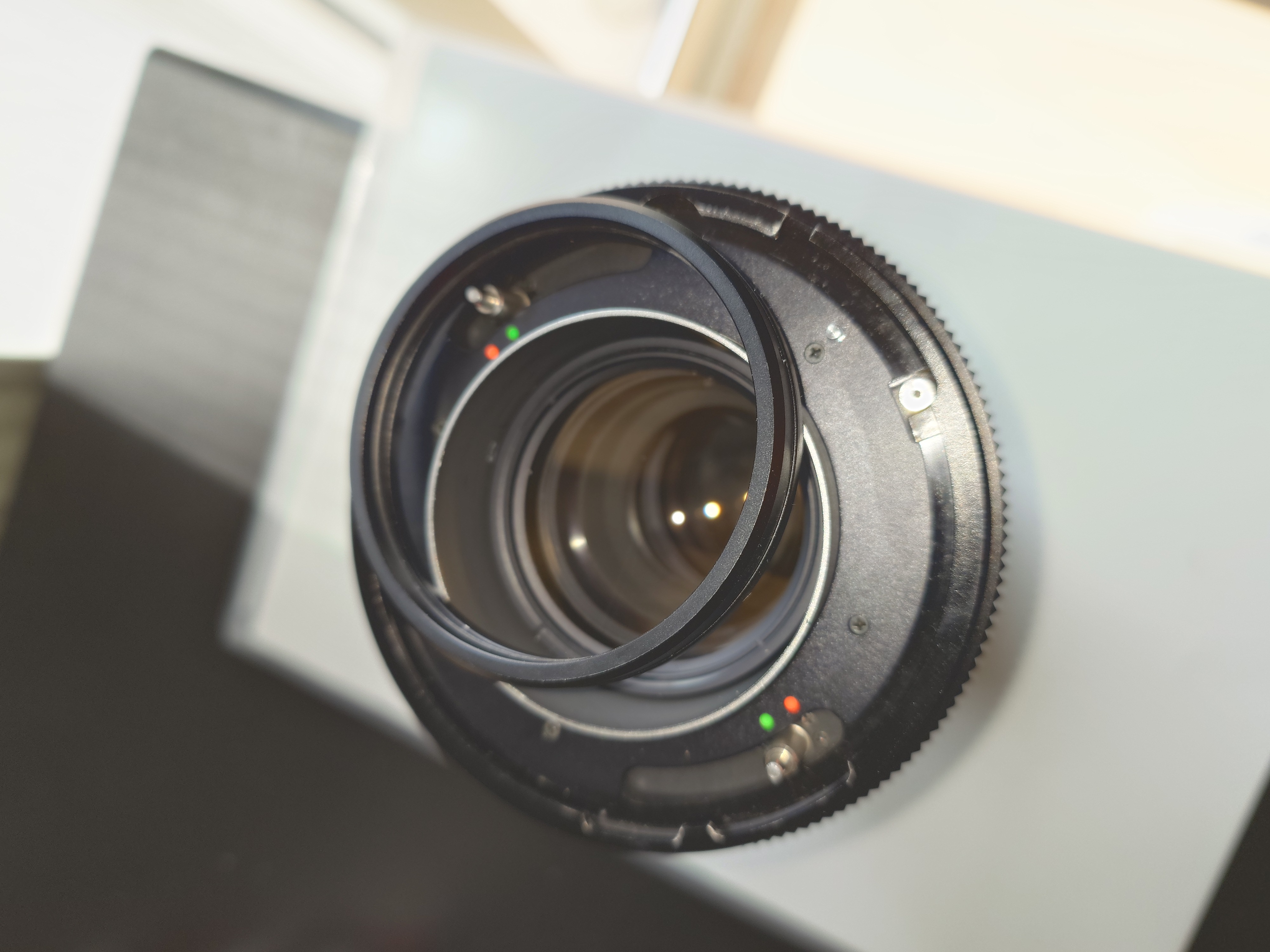

Hi, I had the same issue where my Sekor C lenses did not fit on the extension tube. This chat helped me to solve the problem.
To fit the extension tube, you need to remove the black rings on the back of the lens.
The inner diameter of the extension tube is 52 mm, while the outer diameter on the lens side is 61 mm.
The black ring can be easily removed with a thin pin. Once removed, the lens can be used without any problems.
