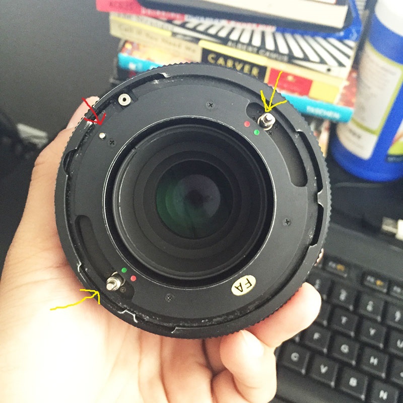

To attach or remove the lens on an RB67 both the body and lens need to be cocked. Lenses should be stored with the shutters released, the lenses for the RB are easy to cock and fire without any tools. Twisting the two pins marked with the yellow arrows counter clockwise until they are lined up with the red/green dots will cock the shutter. Pressing the release button marked with the red arrow while twisting the pins clockwise until they stop will release the shutter. Once or twice I accidentally tried to remove the lens from the body when both were released and was unable to do so but nothing locked up. I don't know if I ever tried to mount a cocked lens to a uncocked body or vice versa. I have heard that it is possible for the two to become locked together though. And I recall reading something about peeling back the leatherette on the front standard and using a paper clip or similar object to release something.
