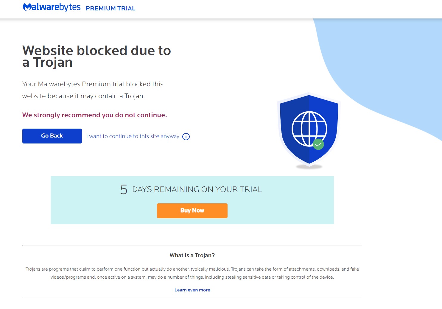

I got this from a demo malware program I'm trying from Malwarebytes. It says it's a Trojan.

No issue with Kaspersky Internet Security and usually it is pretty good at identifying sites that look OK with for instance just a chart but which nevertheless has dangers in it. It may be that Malwarebytes has got it wrong
