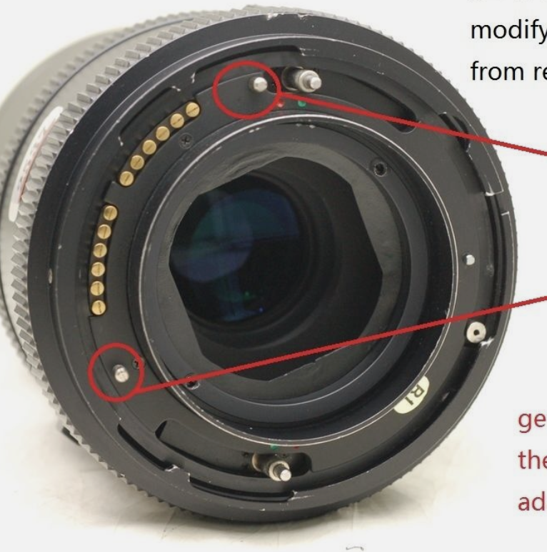

I am working on building an Actus type camera on a 6x9 view camera platform. My plan is to use a Mamiya RB lens (eg. 90m f/3.8) for the objective and mount my Sony A7RIV as the digital back. The front standard would be from a Toyo 23G which uses the 110mm (11 cm) square boards also used on the Toyo 45A type field cameras. I saw the add below on Ebay for a lens board that may work - it says the board is 11.8 cm x 11.8 cm and I am wondering if this would mount on a Toyo 45A type board.

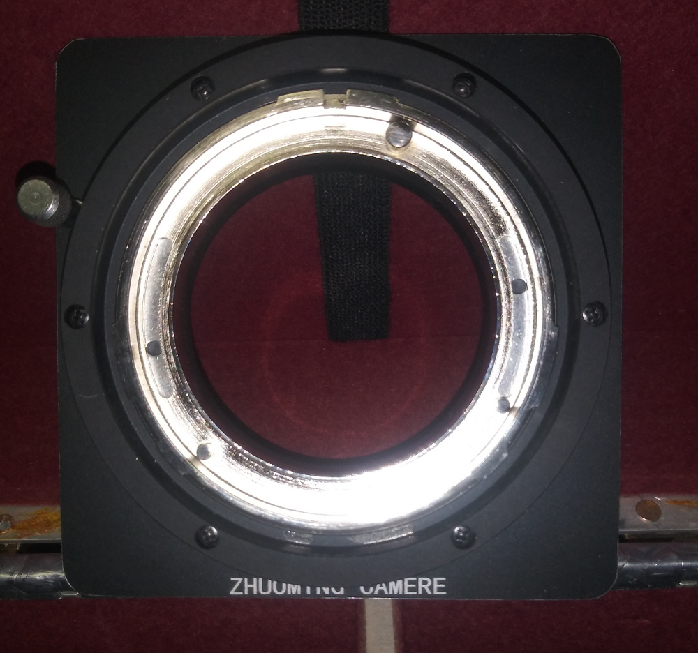

I have one of these -- I can report that they do correctly operate the RB67 lenses I have. The board doesn't fit anything I own, but I keep thinking I can remount the ring with its operating parts on a different size board.
Thanks, Donald. Do you think a Copal #3 bore size (65mm) would work?
Best,
Paul
I'd have to measure the ring parts. It's front surface mounted to the board, as I recall.

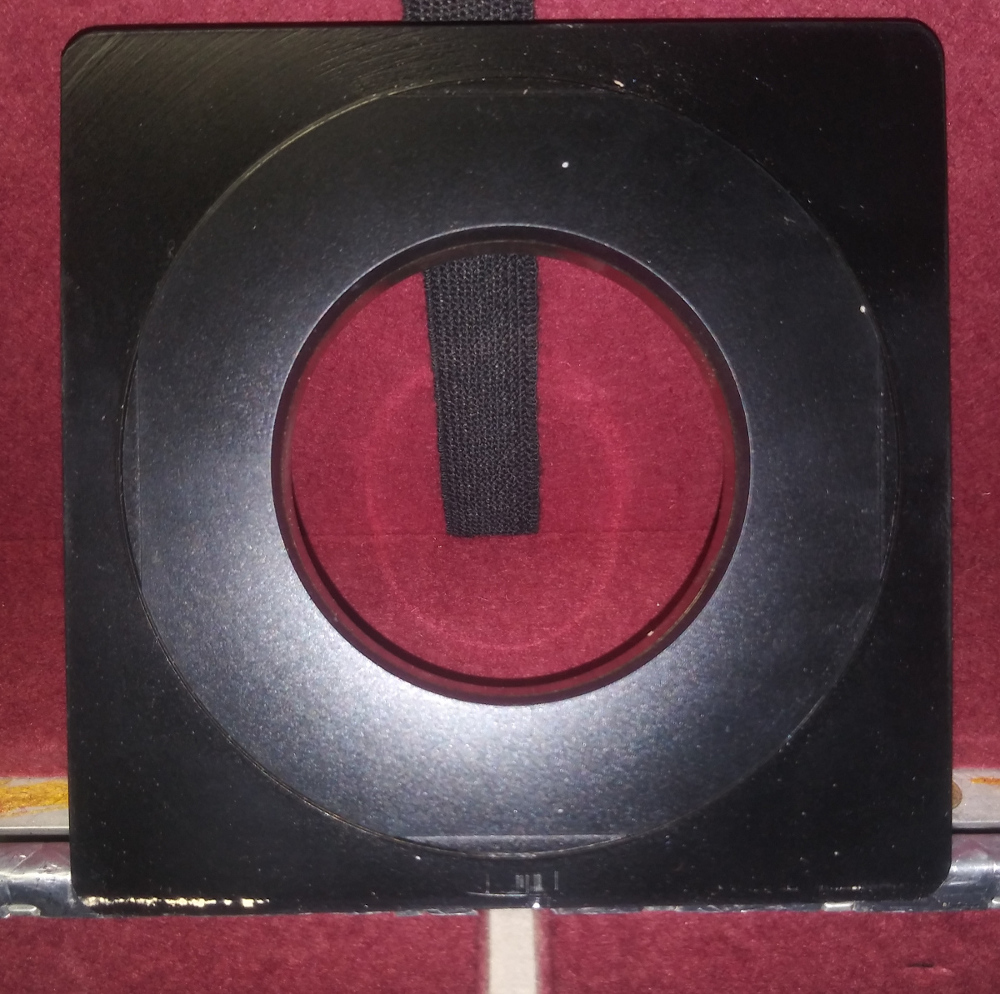

The mount definitely attaches to the front of the board, and it appears to fit on the 118mm x 118mm board with some clearance to spare, so it should fit on the 110 x 110mm board standard for the Toyo. I guess the real question is if a 65mm OD hole in the lens board would be big enough, and while I don't currently have a Mamiya RB lens to measure, I think 65mm would be ok, as the published data for Mamiya RB-SD type lenses is 61mm. The problem than becomes that the 65mm bore may be too large not allowing enough meat to drill and tap holes for the mounting screws. The rear of an RB lens looks like the actual rear lens group is considerably smaller than the lens mount diameter, so perhaps, even a Copal #1 bore (41mm) might be adequate.

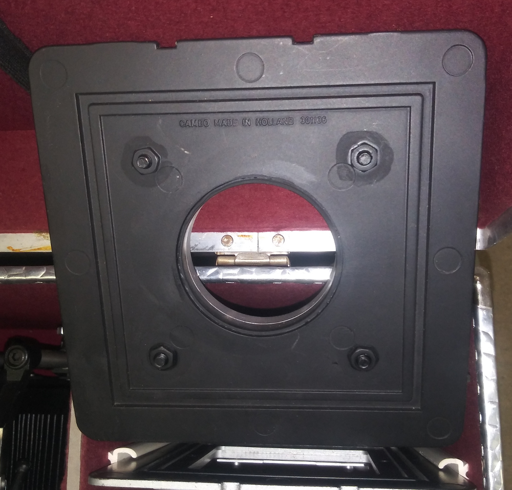

I mounted mine on a Cambo SC board with a copal 3 hole. I centered it, drilled 4 holes and used 4 #8 x 32 bolts and nuts to secure it. I used black polyurethane sealer in the light trap groove on the adapter board and married them. They have lived happily ever after. If I get any free time today I will make images of them and post them.
Measure the opening in the adapter; any board opening that large or larger will be fine. Smaller may still work, too.

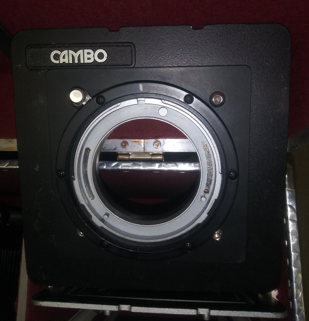

Here is my Cambo adaption.
If I change to another view camera like a Toyo or Horseman I could just unbolt it and move it to the other system.
Here is the one I did for the Rittreck 5x7 view. I had to machine it down on the edges to match the Rittreck boards and machine it on a lathe on the back side to match the light trap of the camera and set the right thickness for the camera.
