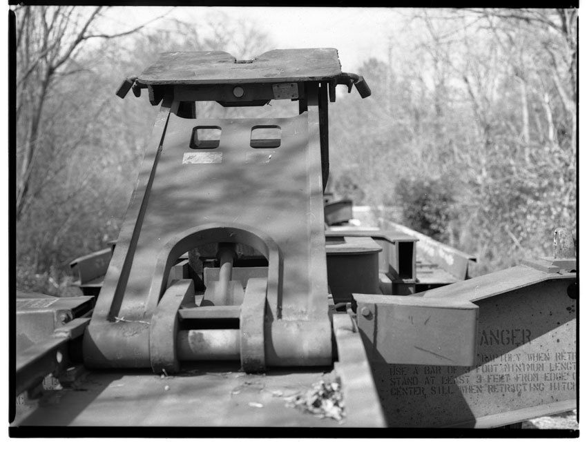

Here is a negative shot yesterday.
This guy is down in the mouth.
tkamiya
Oct 3, 2009
4,284
Central Flor
You are talking about Mamiya M645, right? Almost all lens for this model except for a few (you can tell because there is a flash PC connector on lens) do NOT have a shutter in the lens. Shutter is IN the camera body.
What's wrong with this frame? It looks perfect to me.
If you are shooting with 645 format, you should get 15 frames total. You said you are getting less. Can you explain where the loss is happening? Spacing too wide? Missing at the end? You also said 1/2 frame. Where's this happening? In the middle?
I'm guessing you cut your negs into 4 frames or so each. Can you just scan the whole strip and post it?

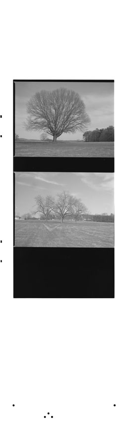

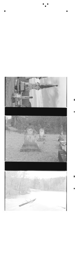

I don't have a contact sheet but here is a scan of the beginning of the roll and the end. The first partial image s actually what should have been the 3rd shot. You can see what should have been shot 4 and 5. This is the beginning of the roll. the you see what the counter and I thought were shots 14 and 15 and the start of the blank end of the roll. the shots between 5 and 14 were all spaced correctly and present. I was testing the meter in the camera and as you can see it is off but has nothing to do with the film advance.
The behavior is almost like the winding mechanism and the insert do not mesh up till the third frame and then it works fine until it gets to what it thinks is frame 15 the releases to be taken up.

I do not have interchangeable backs. The counter resets and advances each time I advance the film. As I said before it seems to take the 3 advances before the film actually moves?
I also tested the shutter/mirror. Opened the back and place the lever on muilt and the shutter curtain opens and the mirror moves out of the way. I checked this repeatedly and no failure. I am leaning to the insert but it is such a simple arrangement. It is very clean and looks new?
