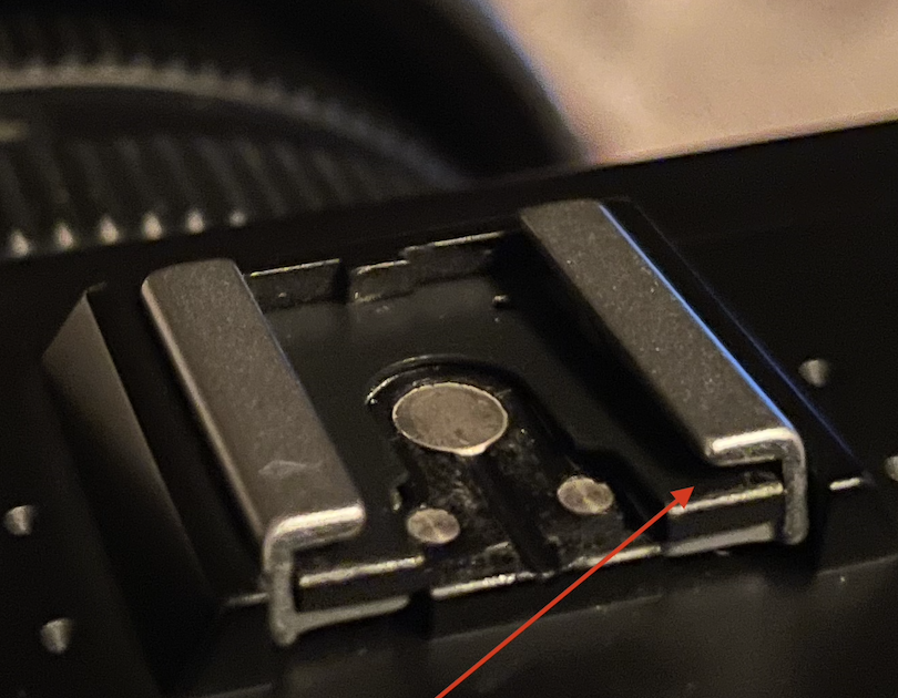

Hi,
I am having this same issue with my Mamiya RZ67...did you ever figure it out?

Mamiya_Repair
Advertiser
Feb 7, 2019
223
Nevada
Your spring plate has come loose and needs to be re-installed. Pull it up carefully with a small screwdriver by the center contact and push it backwards and then you can slide it back into the shoe flush.

I've had the same problem with other cameras. It seems that some cameras have this "extra" plate, and others don't.
K Photo
Oct 8, 2024
New York
I'll try that! Thanks so much!
