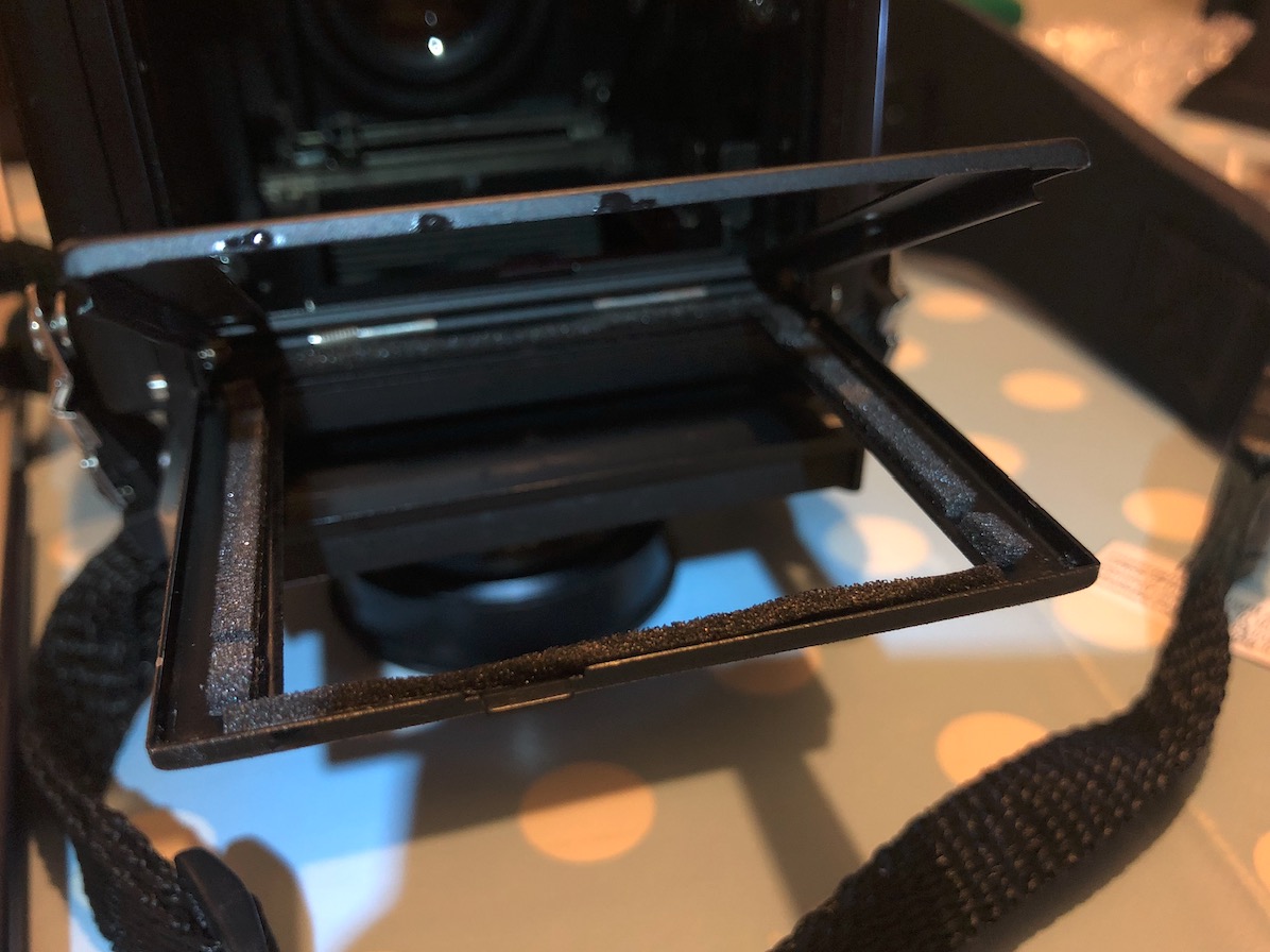

Hi there everyone... I have just got some new seals for the Mamiya C330s, but I thought I would do the screen seals first.
The USCamera screen seals kit I bought doesn't seem to fit the S whatsoever. The gummed up seals I took out were way wider, but the packet that the new ones came in said C330 / C330f / C330s, yet they seem like thin little strips and cubes.
Does this look right? The camera is lens down so the seals are underneath the top frame, squashing the screen against the bottom frame if that makes sense.
I am assuming the screen is placed on the bottom of the frame, then the foam pushing it down with the pressure of the top frame... I am getting a bit confused.
