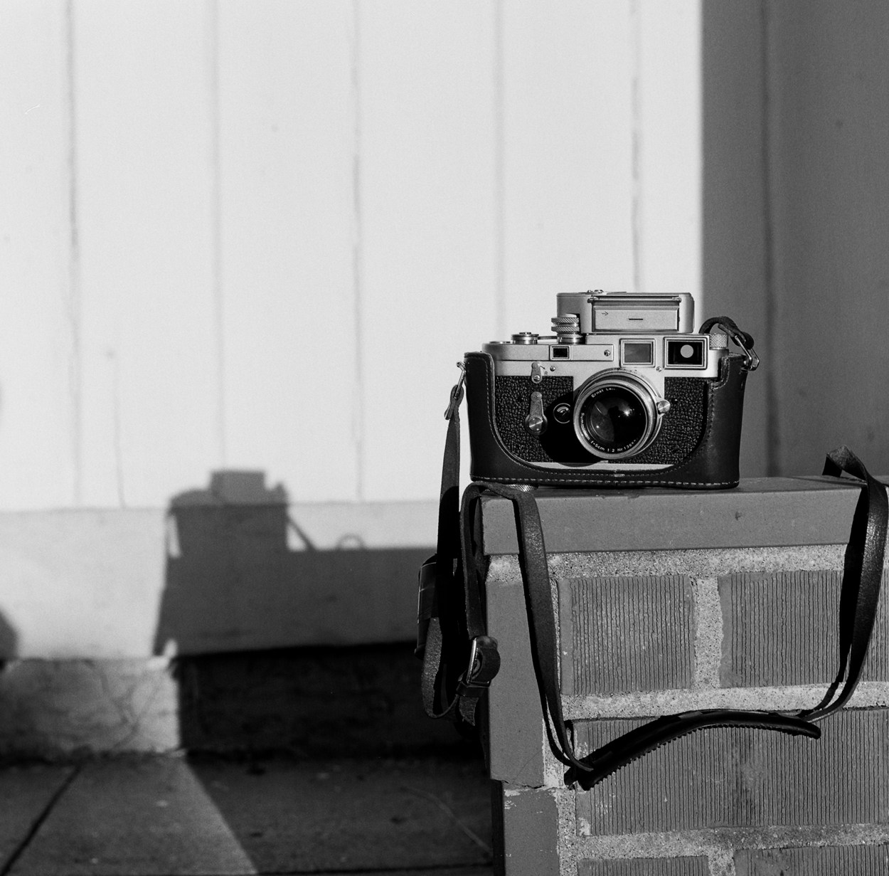

A self portrait, with my C330 featured prominently:

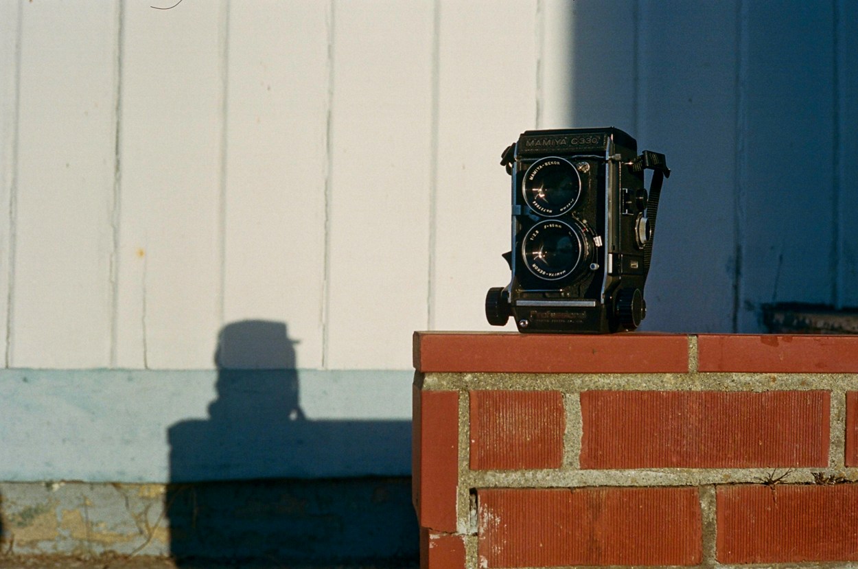

This is mine in Portra 400:
And a shot from the C330 in Delta 400:
Still working on composition with the square format. But if I can't take good pics with this glass that's on me, definitely not on this camera.
