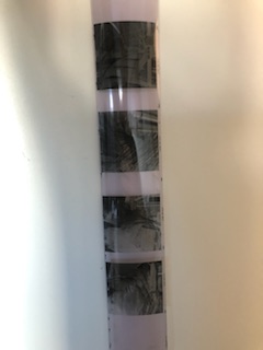

I just ran my first roll of film through a new-to-me Mamiya C330 a d the frame spacing is troubling. Rather than being too close or overlapping, there is a large amount t of space between frames - see photo below:
Any ideas of why this is happening or how to address?
Thanks!

I have a C330 as well. I got it recently and have only put 4 rolls through it. They’ve all had similarly uneven spacing, and one even had a (very) small overlap between two frames.
Anyway, my limited research suggests this kind of uneven spacing is common on these cameras. But I find it frustrating as well and am interested in possible fixes too.

If you are seeing significant amounts of uneven spacing, your camera needs a classic Clean, Lubrication and Adjustment ("CLA") service.
My C330 - owned since the mid 1970s - has been CLA'd once. It has been extremely reliable. It is possible to vary the frame spacing slightly though if your approach to winding the film is quite erratic. I've never had problems with overlap.

Yep need a CLA. Not inherent to camera. Got four of these cameras, all bought used but not abused and never had this issue. Been using them for years with no issues.

Sorry to disagree but no, not that common on these cameras. This based on my experience with them over the years, as well as that many friends. Currently have four but had some more over the years. There are a great lot of cameras where this issue is more common.

After a while of (intensive-) use, the Hasselblad film backs are suffering from the same illness, the only cure is a good CLA...

If you are still getting 12 shots on the roll, and if you don't have any frames overlapping, it isn't broke so don't fix it.
Frame spacing can vary on some medium format cameras for reasons as ordinary as winding technique, the flexibility and thickness of the film base, or how long the film has had to relax between shots. Two people using the same camera but with different film could find the spacing varies between them.

Thanks for all the responses. I am confident that the camera sat for some time and am hoping that exercising the mechanisms may help. I’ve shot just one roll so too early to tell if things are really that bad.
My surprise was that the frame spacing was so wide. It seems that overlap is a more common film transport issue. Hey, at least there were no light leaks!

If the friction wheel slips at all, the spacing is always greater between the frames. To get overlapping spacing, the friction wheel would have to spin faster than the film/paper movement while advancing.
You can see if the friction wheel has tension by pulling on the wheel or shaft. The friction wheel leaves a track on the film edge if it has sufficient tension.

I used to fret about this. I had two Mamiya TLRs (330 and 220 as a backup) and both of them were incapable of producing perfectly spaced frames. They never overlapped though. I serviced one of the cameras by sending it to Precision Camera, and another one came from a person I trust. I also googled and found tons of people online complain about uneven spacing. So now I think the variability is normal with these, but the degree of variability varies based on camera condition and a film stock. If you start to get frames too close to each other, or overlap, then I'd be sending it for service. Otherwise, I wouldn't worry.

If anyone has had a CLA on a Mamiya TLR, any ballpark for the cost? Everything works well other than the frame spacing. I’m getting 11 1/2 frames per roll. Thanks.

I've owned several and used a couple professionally, no real spacing issue, other than just a bit more over the course of a roll. I personally would load an empty spool in to the correct side to allow the camera to function as loaded, and I'd burn thru the equivalent of many rolls in on sitting. If it fails then it would have in a few rolls anyway, and you'd be needing a CLA regardless. After those test firings I'd do a test roll and see if that changes it. The C series are fairly heavily greased on the wind mechanism and obviously a good CLA will clean out the old lubricants and be replaced.
It may seem unusual now but back in the day, I'd do 5-8 rolls in one afternoon sitting and at least a dozen or more at a wedding, and I felt I was hardly stressing the camera. At that point in time the C system was falling out of favor, most shooters having gone the Hassy/Bronica interchangeable back SLR route, but all the C series were and are absolute brutes of cameras, designed and built to shoot dozens of rolls day after day. A couple of rolls of test firings certainly won't hurt it and perhaps might help it in the short term, but a CLA is likely required.

Make sure you aren't winding 'fat rolls', keep the leader very tight ideally with a finger on it while you advance the film to the arrow.
