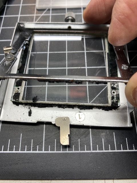

I just received a Mamiya C330 today and noticed some black dust inside the camera.
I removed the WLF and saw that the dust was coming from under the ground glass. The light seal had dried out and was crumbling.
I removed as much as I could so that dust wouldn't fall onto components inside the camera, but I wonder if the loss of this seal means the ground glass/focus is now out of whack.
Here's the part and where the seal is dried out. The GG assembly is on its back in the photo.
Is this an important light seal or was it just a seal that merely kept the two glass pieces together?
Will I have to re-calibrate focus? Anyone know how I'd go about that?
I ask because after screwing down the top metal square, it still has play, so the seal must have kept those two pieces from moving as well.
Thanks in advance.

Technically, that isn't light seal material - it is merely foam separator that ensures that the screen itself presses against the adjustable screen height setting studs in the mirror box.
If you haven't already looked at it, here is the link to the relevant section in Graham Patterson's excellent Mamiya C series TLR reference - http://grahamp.dotinthelandscape.org/mfaq/mfaq-09.html
Graham posts here regularly under grahamp - perhaps he will chime in.

..there 's foam in a C 330s screen frame under the top half of the frame. So it's slightly different from an interchangeable screen in an OM or Nikon Fxx. It's purpose, I think, is to push the screen against the lower part of the frame. The screen will then sit properly on the three adjustable screw heads that contact it through cut-outs in the lower part of the frame. The foam deteriorates, just like in the earlier models, but the focusing accuracy isn't effected. The screen rattles in the frame though, and foam debris is distributed into the camera.

True. I was mostly highlighting that the C330/C330f exchange the frame/screen as a unit, while the C330s keeps the frame with the camera body. One of the reasons the 's' screens are not interchangable with the earlier models. At the risk of over-generalizing, screens are pressed against a reference surface or a three-point defined plane by some sort of spring or compressible material.

I got the foam today, installed it and crossed my fingers as I shot a test roll. Installation was easy, if a little delicate.
I shot a roll last week without the foam, and honestly, it didn't look back-focused, just perhaps about 1/5mm off.
Anyway, I'll see what today's test roll shows.
Thanks for everyone's help!

Well, the film looks pretty good, but I have a nagging feeling that focus is off by a hair and a half.
I really don't relish the idea of having to tweak the focus screws. I'll check again with a loupe and a spare ground glass before doing anything.

@Neil Grant I see why you said that. It makes perfect sense when examining the C330s focusing screen housing. But the degraded foam did cause back-focusing for me. The reality of old deteriorated materials is messy. The old foam turned into sticky crumbs which spread around, under and on...

@Neil Grant I see why you said that. It makes perfect sense when examining the C330s focusing screen housing. But the degraded foam did cause back-focusing for me. The reality of old deteriorated materials is messy. The old foam turned into sticky crumbs which spread around, under and on the edges of the screen, leading it to happily exist in elevated state without rattling. I have several rolls to prove it.
I was about to comment in this thread confirming Neil's opinion that deteriorated foam cannot affect focus position (because gravity pushes the screen down as well, usually) but your experiment reveals the messy nature of real life, and the experiment is much better than theory! Thanks for doing it and sharing it here, it has inspired me to replace the foam on mine when I get a chance!

I think I fixed the focus issue I was having after I'd installed some new foam.
Looks pretty sharp in this photo, but some other photos it still looks off by a hair.
My eyes must be going soft on me.
