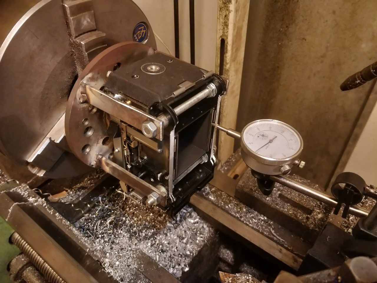

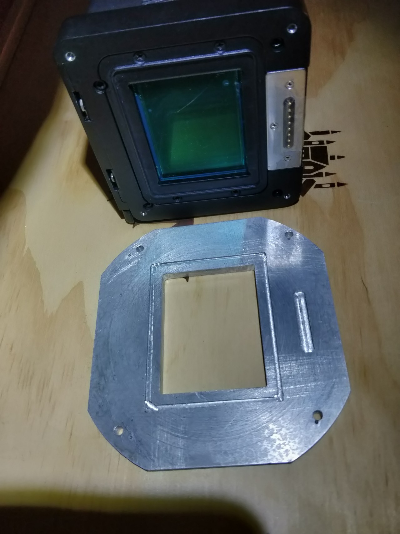

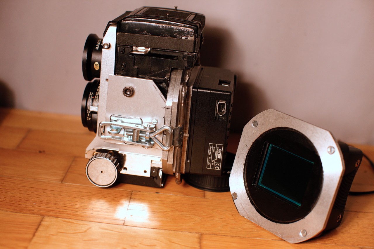

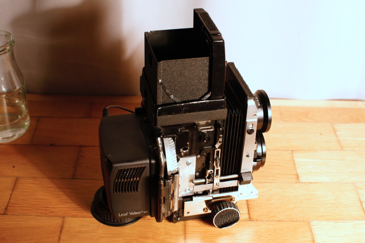

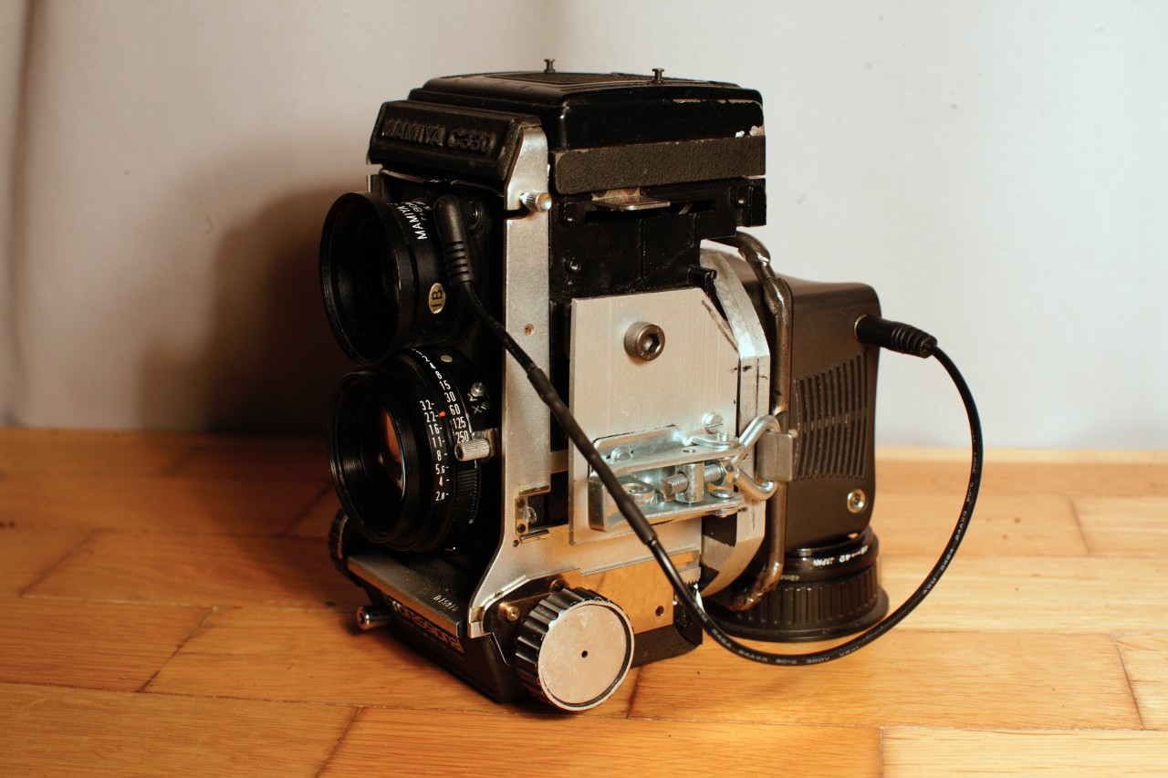

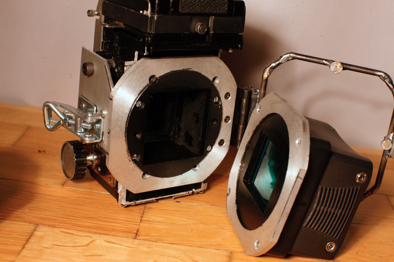

Hi, i am new here and wanted to share my recent project, modding a beat up c330 camera to be used with digital backs.
Ive cast and machined adapter plates from aluminium, and digital back holder is made from welding wire and house box parts, like latch and hinges.
Both digital backs are 22 megapizels and 48x36mm ccd sensor, and the sinarback is infrared modded.
Camera has also rotating back feature.
What do you think? 😁

So the camera back was milled down, one part of the alloy mount added, then the other alloy mount on the digital back is clamped to that. This puts the focus in the equivalent plane to the focus screen? Or did you have to modify that?
The wind on won't be cocking the shutter (and I see much of that mechanism is gone), so you must be doing a manual cock.
I suppose the standard focal length for that format would be around 48mm, making most of the lenses on the long side.
It's a bit more extreme than some long roll Mamiya TLR conversions i have heard of, but if it fills a need, go for it.

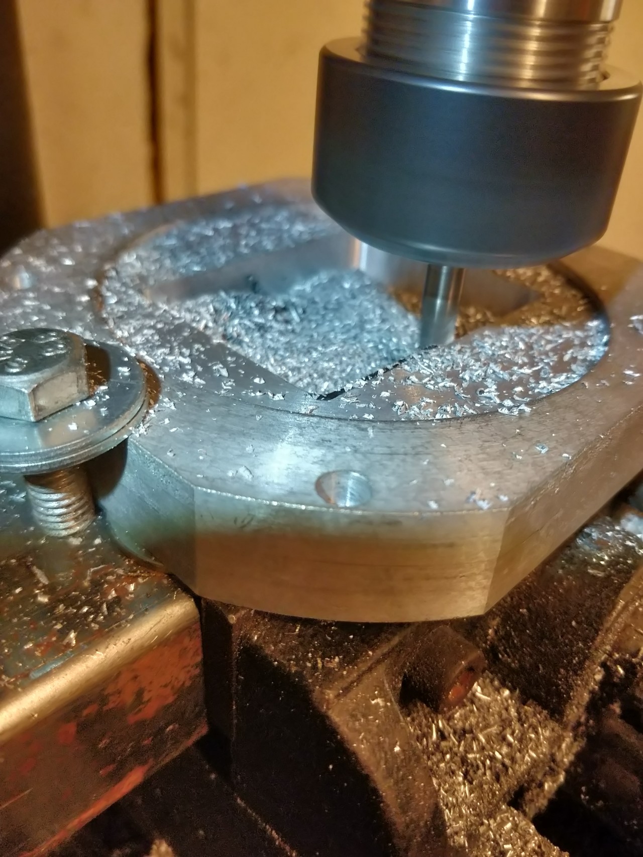

Yes, camera was actually first cut in a lathe, where i could get my cutting done in absolutely same plane than the original film plane, so i woudnt get tilting for the digital back. Rest of the material was milled off.
Focus was calibrated with taking close focus test photos, and seeing if the wiewfinder focus matches the photo. Then i disassemble my adapter plate, and took some material off with lathe.
I had to do this 3 times, but now focus is spot on, and all the focus screen parts and front standard are original!
The cocking mechanism is only half way removed, it might be possible to fit to this once again, but ill have to manage with manual cock action for now :smile:
I think the 80mm lens in this is equilevant to 57mm in 35mm camera. A bit longer for sure! But its okay, i have the 55mm lens also.

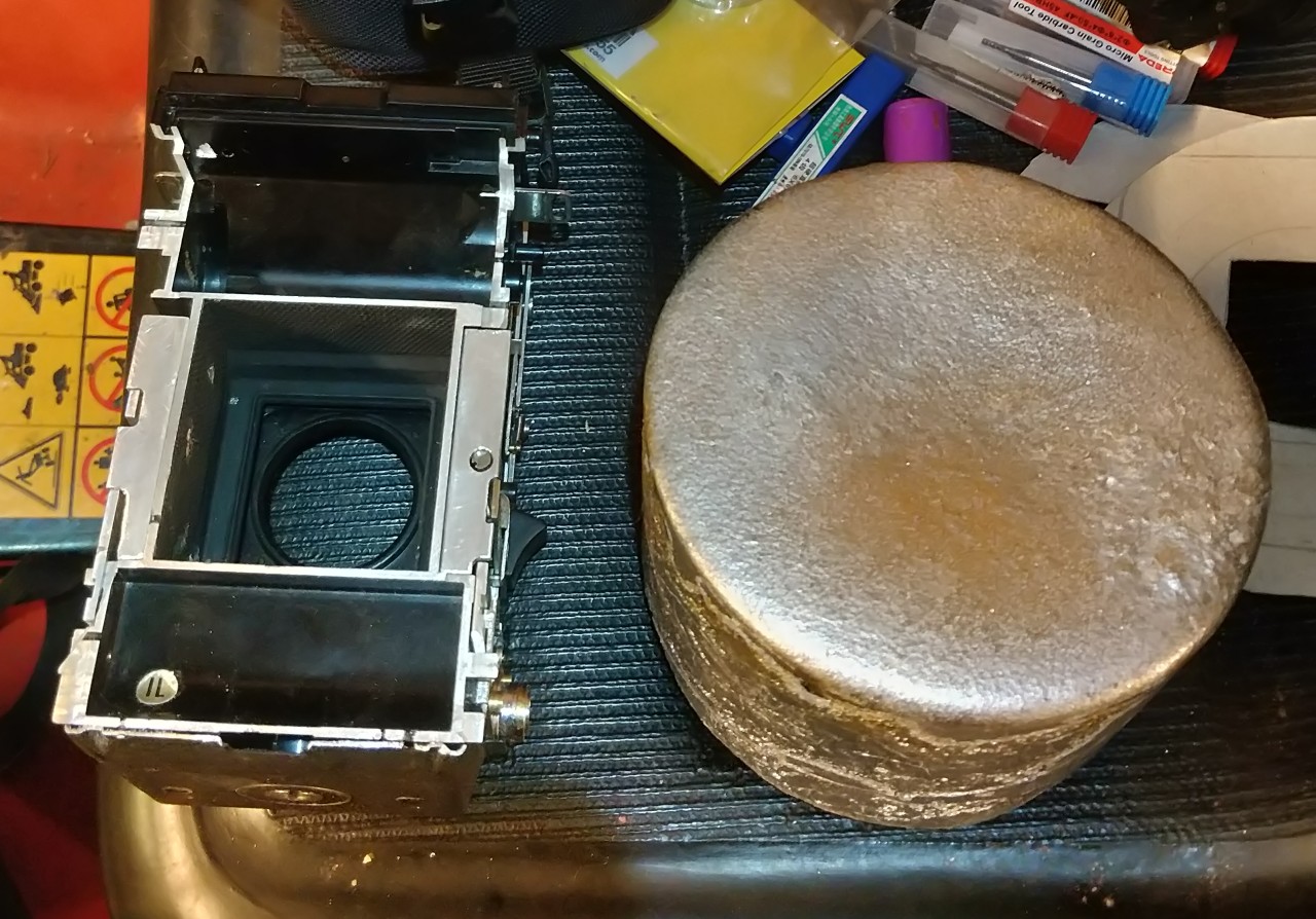

Btw the adapter plates used to be my friends car rim 😁 It was cut down and cast to a 125mm axle (that is in the last photo) and machined from there to make the plates.

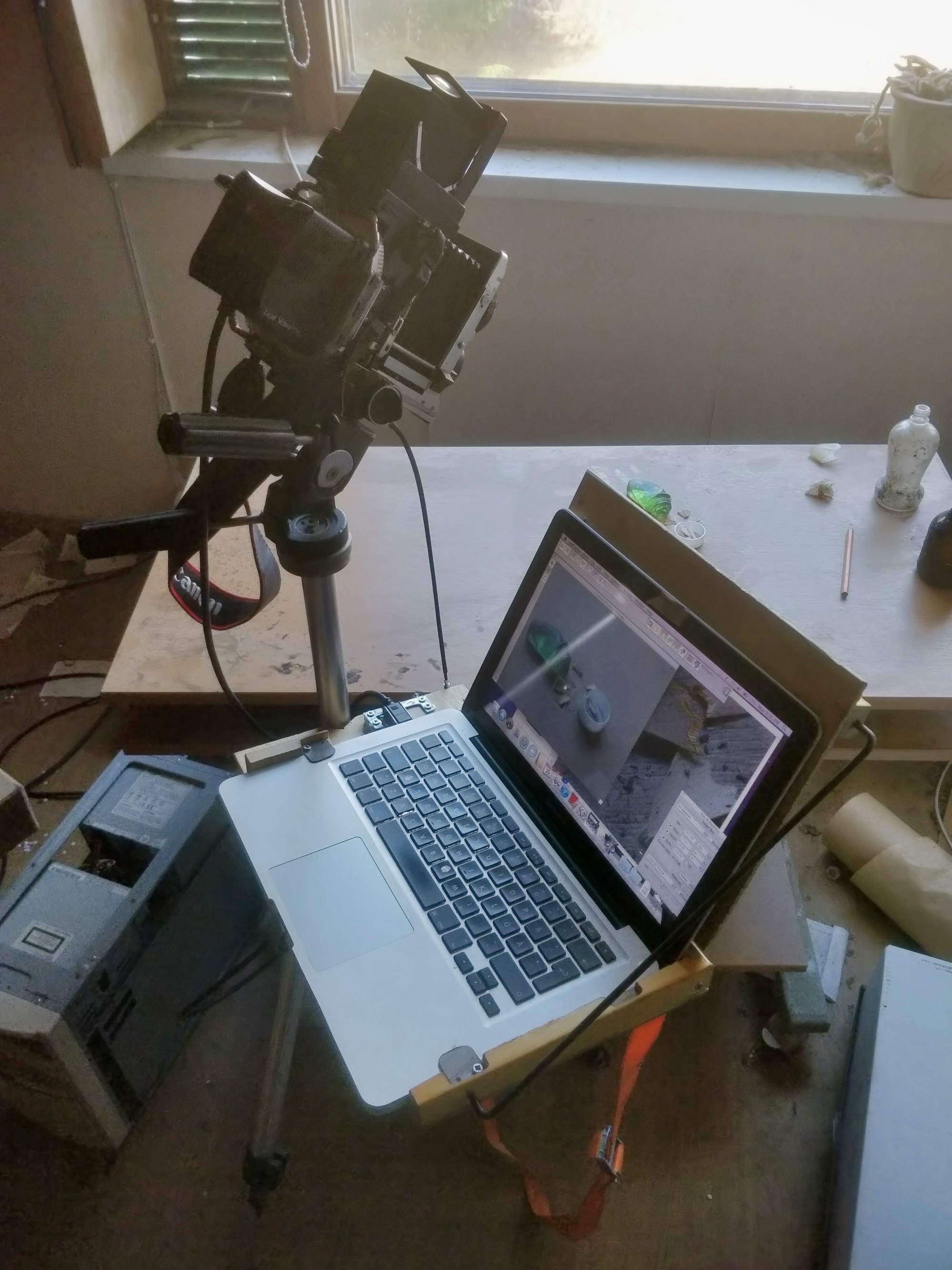

On the laptop photo you can see the setup, how i mounted macbook to tripod. Its handy with these old digital backs that has to be shot tethered to computer.
As shooting experience this is almost like large format, but its digital. 16bit per channel, 22mp, 36x48mm ccd sensor on the camera.
