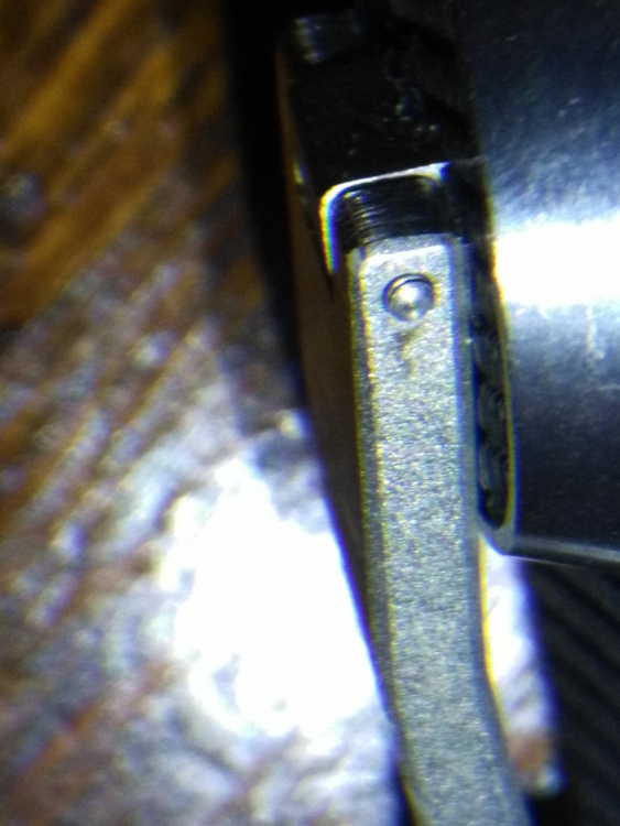

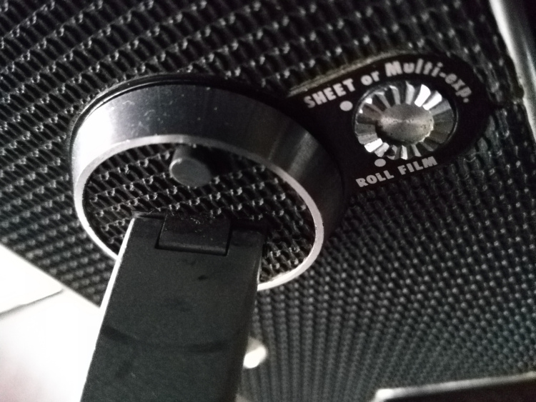

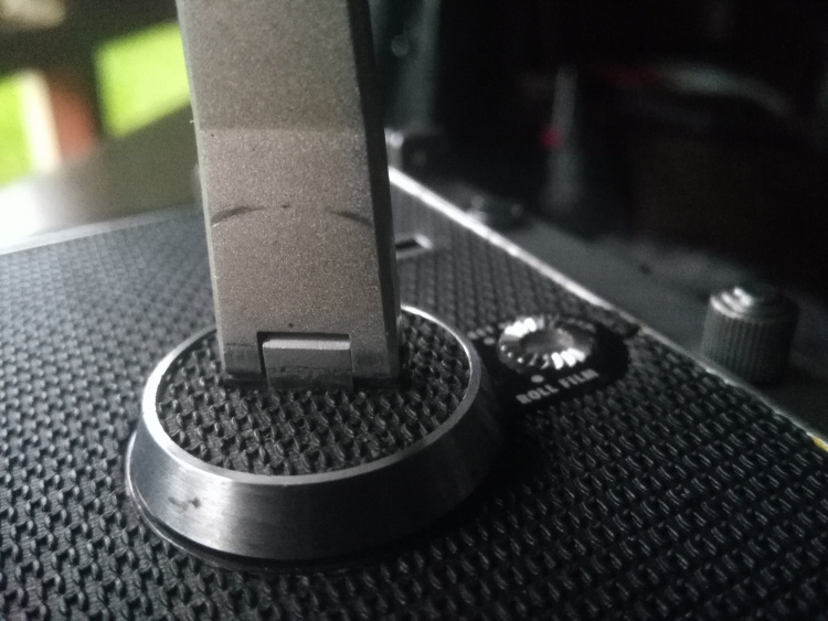

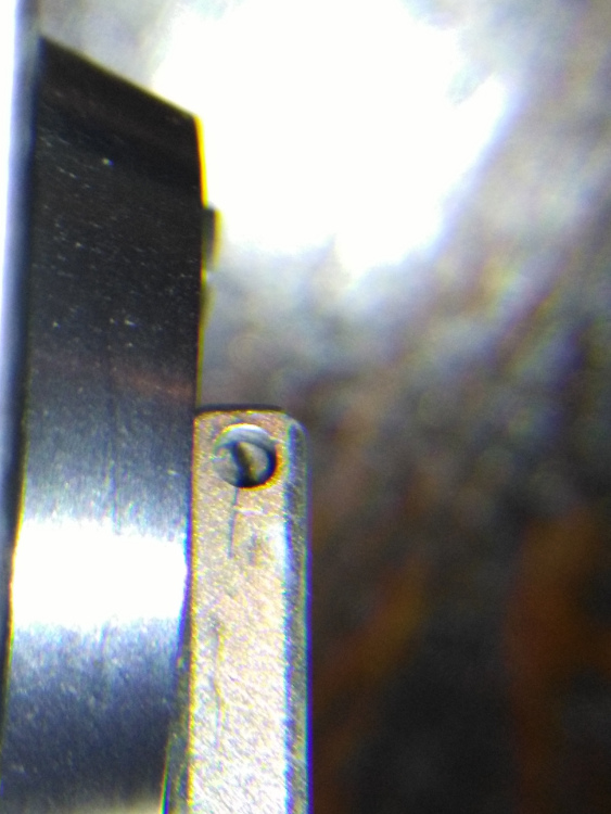

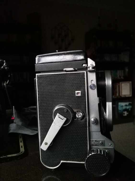

Mine is a C3 but I don't imagine they changed the crank handle between models. Do any of these photos show you what you need to see? The last two show the retaining pin from either end. My apologies for the blurriness, I was trying to hold the camera on an angle in one hand and my phone in another and an illuminated magnifier in between! I took photos of my Yashica Mat which has the same mechanism but with slightly more of the actual mechanics on show. If it helps at all, I've fixed both a watch band and a trinket box with the same worn bushing by pushing out the pin and shoving a thicker needle in its place and snapping off the protruding pointy end - I am nothing if not the epitome of professionalism! :D
Mamiya C3 TLR:
Mamiya C3 1.jpg Mamiya C3 2.jpg Mamiya C3 3.jpg Mamiya C3 4.jpg Mamiya C3 5.jpg

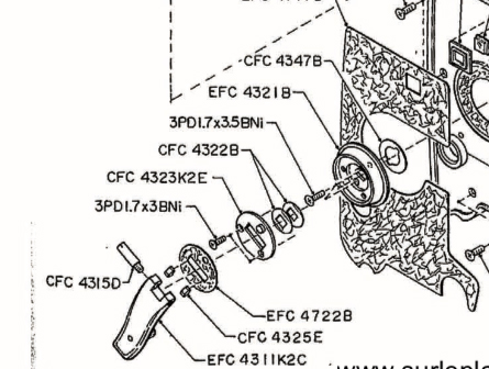

I suspect the winding handle has been removes at some point and parts have been lost. In the image below Parts CFC 4322B are spring cup washers which apply light pressure against the winding handle via the intervening parts. The items CFC 4325E are very small (think 5mm length) opposed nylon wedges that act as detents for the handle in the open and folded position. If any of these,or intervening parts, are missing then the handle will flop around. This diagramm is for the C330f but I'm fairly sure that it is the same as your C33. Probably asking if anyone in the forum has a scrap camera body that may be willing to part with any of these missing items is your best bet. Hope this helps.

Thanks Keith, that's exactly what I was looking for. I had suspected it was something like that after seeing a video on a C33 teardown-- but the video resolution wasn't that great.
The screw in pin (4315D) was halfway out of the handle, so I'm sure someone's had it apart before. It's the two 4325E's that are missing.

My luck continues. Bill Rogers of billrogers.com had the parts in stock at a reasonable price.
