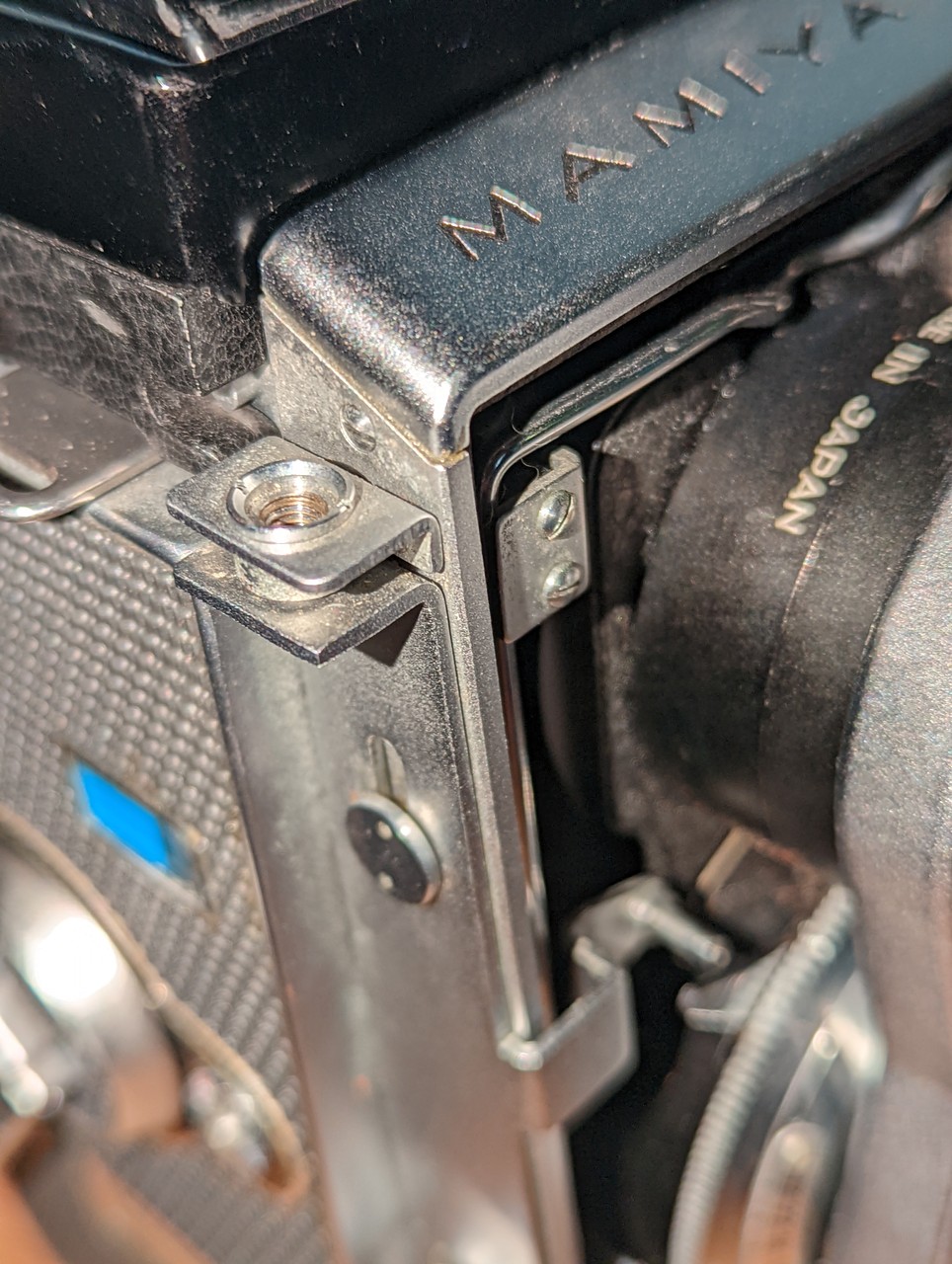

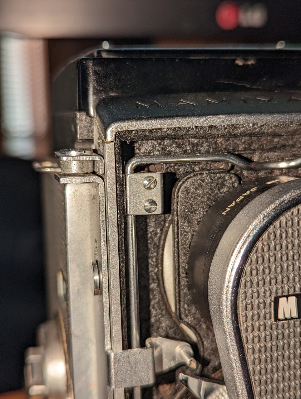

Greetings Fellow Weightlifters,
The shutter button on my C3 is a bit sticky or notchy, and has been since I first got it a while ago. By 'shutter button' I mean the sliding mechanism on the side which pushes down on the lens's own shutter lever.
After some fiddling and staring I noticed that the vertically-sliding part leans away from the side of the camera rather than running exactly perpendicular. The screw which hold it in place won't go in any further but leaves a gap of about 0.5mm.
If I push the button's mechanism against the body when I push down the button then the action is all smooth. Similarly if I use a cable release it's OK - the end of the release engages with a divet which pushes the mechanism against the body too.
It occurs to me that a washer might be missing but despite trawling through umpteen pictures of C3s I haven't seen anything to confirm or deny this.
So my questions are: am I missing a washer? Is something bent inside? Is this normal?
I've attached a couple of pictures which I hope show what I mean.
Thanks,
Sig.

That vertical running bar is bent outward, you can see that clearly in the first pic. You could take it off and straighten it, but putting a washer in there like you mentioned should fix it too. Once it's off the camera you can go to the hardware store and find something.
Did you ck to see if the retainer screw has backed out?

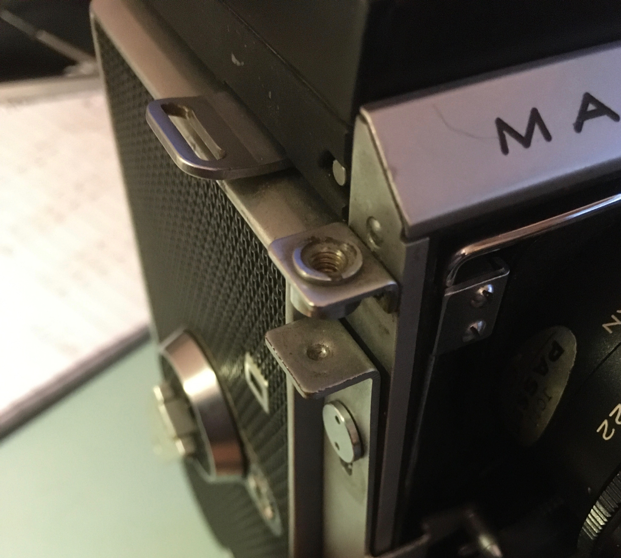

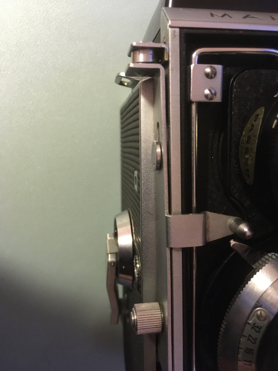

That screw with the two holes in it, should go in further. I'm looking at my C33, and there's no washer, but no gap, either.
If I had to make a guess (and I am), I'd say there's a problem with said screw-- either cross-threaded, or some crud in the socket.

Mine looks the same: the little brass screw fits snugly up against the release lever (without any washers). Try removing it and having a look in there--could be something fouling the mechanism and causing the release to bind. Playing with mine, I noticed that it's a bit sticky; I think I'll put a little graphite in there and see if it makes it smoother...

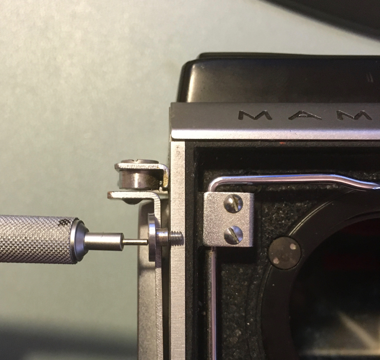

I had another look and the thread is clear - the whole of the threaded portion of the screw can go in. There were two very thin plastic washers, one under the head of the screw and the other between the sliding arm and the body. I think the problem is that the screw is not the right size because the unthreaded portion is too long - see the attached photo where I've propped it on the arm to check the thickness. (Yes, I've only just noticed the mucky splodge on my favourite pencil!).
Do the later C models have a thicker arm? If so perhaps that's where this screw comes from, or perhaps from a different kind of camera entirely. It looks like the solution is to get some more very thin plastic washers to build up the exact thickness necessary, plus apply some graphite to the sliding arm - any suggestions for what to look for when buying the latter?
