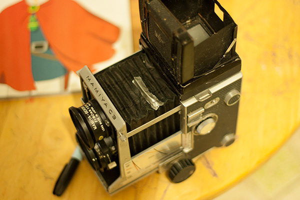

So I dug out my Mamiya C3 and I'm getting it ready for use. I had to do *this* when some kids decided that it would be fun to rip the bellows:
Duct tape on top of some light blocking fabric. Completely serviceable, but I'd like to have the thing CLA'd and the bellows replaced if possible before I start using it again.
Who can do it? I've been almost three years away, so I have no idea. All I know is that I still have 8 rolls of film I want to shoot, fixer that still works, an almost full container of HC-110, and a lead on an enlarger close enough to me to actually go get. I'm ready to give it a go again. :smile:

I tried to find some bellows for Mamiya 'C-series' cameras several years ago.
Not much luck...affordably anyway.
Ended up acquiring junk cameras for parts...cannibalizing the bellows from them.
It's the cheapest way to go, now days...for repairing Mamiya TLR cameras.
Do note...there are actually three bellows on Mamiya TLR's.
There is the outer bellows you see. That bellows covers two, separate, inner bellows.
One inner bellows for the taking lens, and another for the viewing lens.
The inner, taking-lens bellows is well protected...sitting below the viewing bellows,
nestled between the side rail racks, and above the bottom rail.
Any minor light leak in the upper, viewing-lens chamber is of little consequence.
If your light seals on the rear film back/door look okay...run a roll of film through the camera.
You may find out you're not having any problems from the bellows.
Marc

I apologise if you know this already, but inside the rectangular bellows is another bellows which is square and connects the taking lens to the film gate. Even if the outer bellows were not there, the inner bellows would still be light tight.
Therefore, as long as you have patched it up enough to be able to use the viewfinder, you should have no problems.
I have a scrap C3 (or C33) in a drawer at work. If I can work out how to remove the bellows from the body you can have it. As I'm in England, it would not be worth posting the whole thing.

The fact that the bellows is actually of three part construction may mean that you don't have to do anything with it - unless the rip goes right through into the inner bellows.
You may want to replace it with prettier tape though.
PS - welcome back
The duct tape lends a professional look, don't you think? And this?
Just makes it even more special.
(I'm actually going to replace the waist level. However, I'm keeping this one for the heck of it.)

I'm going to bookmark that. camerarepair.com quoted me $320 for the CLA of the lens and the replacing of the bellows. Since the bellows are still light tight, I'm not spending that. The lens cleaned up well and is working snappily and the body is a bit beat up but still in good enough shape. I'm just going to leave it alone for now and I'll order the other bellows if I start getting issues of failure.
