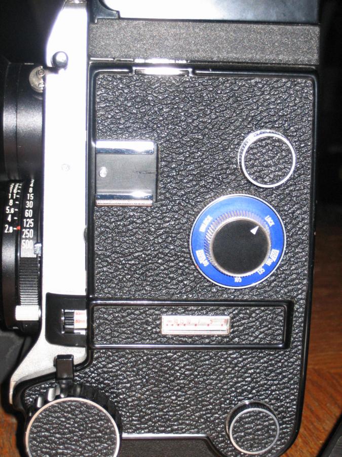

I'll try here too... On a whim I bought what looked like a very nice Mamiya C220f for a decent price, including paramender, 80/2.8 and a lens shade. There was only one little detail missing to make this perfect: the upper film spool knob.
After looking in the manual and trying several non-destructive ways to open the back without success, I've come to the conclusion that unless I am able to find a spare part, this is going to be the most expensive paper-weight I've ever bought. :sad:
Anybody knows if someone can supply the spare part or make a modification so that the camera works?

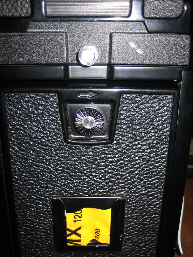

Im almost positive that im mis-reading your post but if you are trying to open it here is how the c330 opens. Turn the knob to the right and then slide the knob to the right. Here is a photo of the back door knob that opens the camera. Also i included a shot of the side, The knob to release the upper spool is spring loaded and you just pull it out to release.

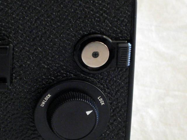

The washer seems original, and no amount of pressure will budge the washer. Inside, "under" the washer, there is a linkage in the lower part of the hole which moves when I push down the cover lock. In the upper part, there is a moveable tap, but pushing the cover lock and simultaneously pressing the tap upwards affects nothing either. So far, I have not had any luck in finding any spare part, nor another 220 f.

Right now, faffing about with the camera for the Nth time, trying to open the back, I finally figured it out. As any riddle, simple once you've solved it. The upper pin under the washer in the photo needs to be pressed into the camera, then pushing the plastic lever downwards.
Major breakthrough. :D
