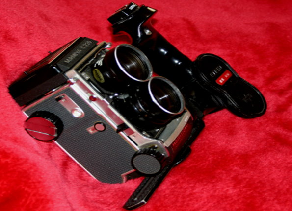

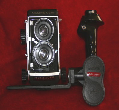

I'm posting these pictures for you to see, then I'll back up and read all your replies. Thanks for posting. I'm trying to justify the bucks for another camera. (Maybe while I'm working through it he'll drop a little more off the cost. Maybe I'm the only one looking.)

If that's the camera for sale, be advised that it is equipped with the 55mm lens set. That's pretty wide on 6x6, so just be aware of what you're getting. An 80mm lens set won't set you back too much though, if you're of a mind to get one. Eventually, you might want to look for the 105 mm or 135 mm lens set to round out the rig. The 135 mm is great for protraiture, and the 105 is only slightly long and can be used very successfully for general photography.
jgcull
Jul 11, 2003
920
nc
>>>it is equipped with the 55mm lens set. That's pretty wide on 6x6<<<
Yes, it is, and I don't know if I can justify going after more lenses for yet another camera. I may just tame myself on this one, though the body looks mighty interesting to me!
The 55mm lens is a very useful lens, and relatively expensive. You may very well be able to sell it for the $125.00, if it is in reasonable shape.
An 80mm lens would likely be cheaper.
Many here might be willing to buy the kit for the lens itself. The body looks good too.

From looks alone, that's an excellent deal. If you don't want the wide (55mm) lens, it should be quite easy to trade it for an 80mm plus cash to boot. You could end up with a $75 C220 (including the 80mm lens).
