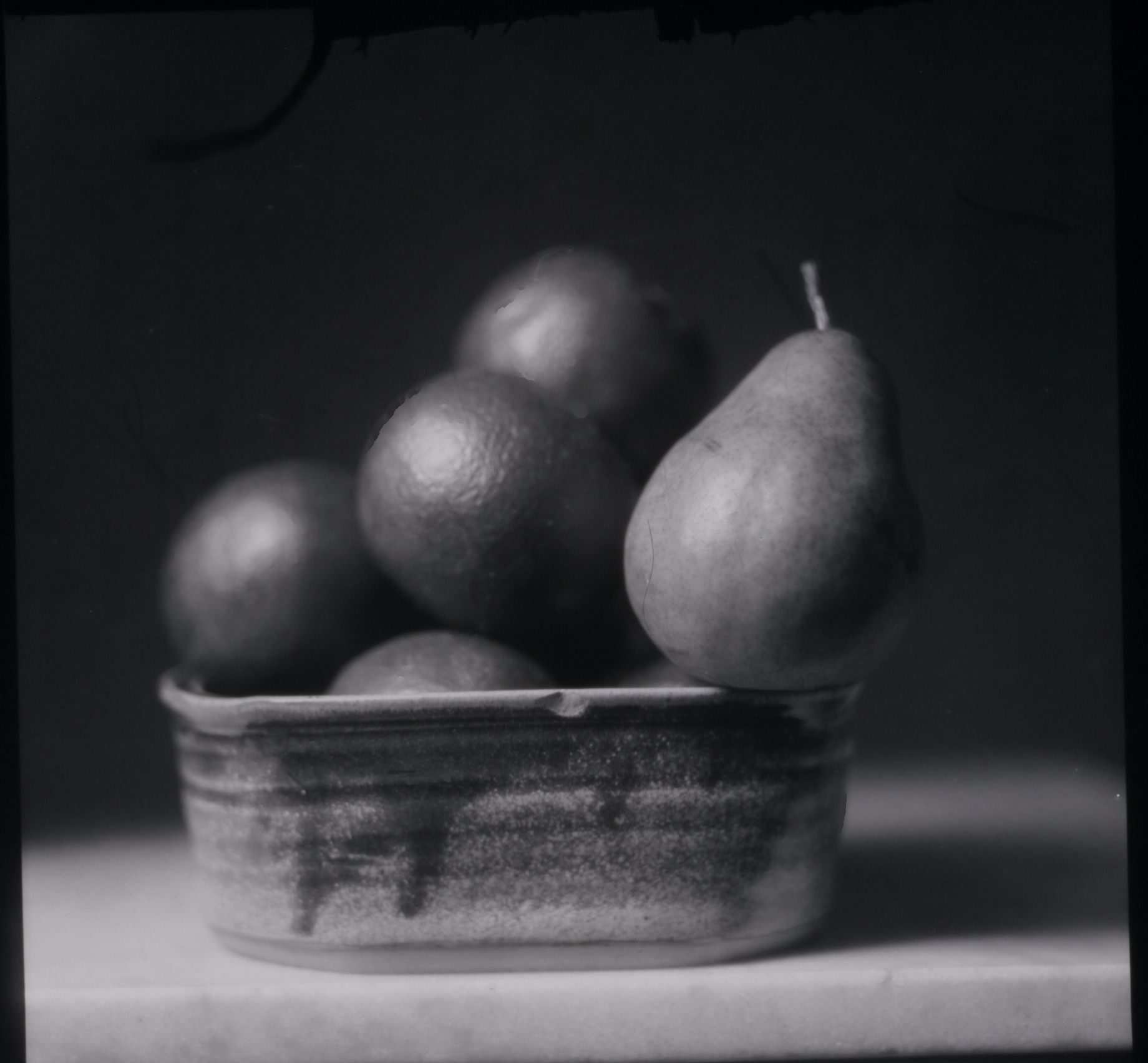

Hey guys, a while ago I posted to see if anyone had put paper into their RB67 Polaroid back. Well I tried it and it didn't work, so I borrowed a TLR and sticky taped some paper to the pressure plate, et viola!

Nicely done! Is this a reversed scan or a scan of contact print?

Rick, this is a scan of the negative. I couldn't be bothered doing anything more, just wanted to see if it could work.

That looks good! I've thought of putting print paper in the cut film holders for my Mamiya Press - you've got me inspired.

I rated my paper at 3iso. I had to move my flash to within inches of the subject and fire it on full power. The lens is wide open. It's a 105mm f/3.5.

Very nice and dreamy photograph. Love any alt process!

Yes it would be good. I'd like to make more exposures on paper. It' easier to use cut film holders on a view camera though.
Note, the sensitivity of the paper has rendered the oranges very dark.
