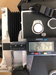

Greetings, I have an issue with one of my two Mamiya C220 cameras. On my “problem” one, the bellows need to be racked out 25.8mm to achieve infinity focus - regardless of which lens I use. I have a functional C220 so I’ve been able to swap lenses and viewfinders to help analyze this problem. Both cameras have an identical number and placement of shims under the focusing screen, and both mirrors look identically mounted and positioned. Using a focusing screen at the film plane, I’ve affirmed that focus is the same on the film plane as in the viewfinder, so I can still confidently take photos, but the close focus range on the problem one is limited to around 3 feet compared to my “good” C220 which will focus to about 8 inches.
If the focus on the film plane had been different than that of the viewfinder, I would guess it was a mirror placement issue, but now that doesn’t seem to be the issue. There is one screw missing in the focusing screen assembly on the problem camera, so it has been opened before. The photo below is of the camera set at infinity focus. Any ideas about the cause or possible fix of this issue will be greatly appreciated! Thank you in advance.

Thank you for this. I’ll be conducting several tests as you’ve recommended and see if I can find any pattern in the strangeness. I’ve affirmed that focus on the film plane and in the viewfinder are identical. The lens mounts are identical and lock in as they should be with no incorrect fitness to the body.
I have not yet taken measurements of the differences between the two cameras besides what I see. In addition to the amount of bellows extension, I will see if both cameras have lens panels that are parallel with the film planes. The lenses seem to be seating properly. The idea that the lens plane and film plane might not be exactly parallel in the odd camera is something I hadn’t thought of, thanks for that. I’ll be inspecting that aspect closely.
I have found that both cameras have the same two thicknesses of shims under the front of the focusing screen assembly and one has one washer on the left rear screw of the focusing screen assembly while the other has a washer on both rear screws.

Here we go. Mamiya C220 body (not C220f), original focus screen (matte with central fine focus spot. Chrome fittings, no modifications. The target was a cell tower about 1/4 mile or 450 meters away against the sky in good light. This has enough detail to resolve well, even with the shorter focal lengths.
All lenses in black Seiko shutters, except the 65mm which is an older Seikosha-S.
Lens panel extension at infinity focus by screen, measured as shown in the accompanying image.

I measured the infinity focus on the scale side at the mid-point to try and get a standard location. I am really curious if either of the camera bodies in question have significantly different values.
