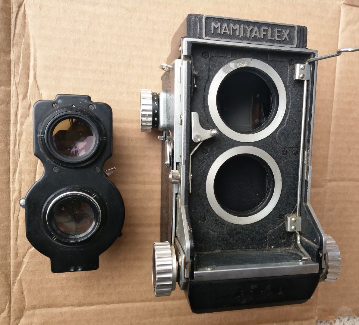

Graham, I sent him the service manuals, so that should help.
Hi Kirks: hope you're still active, this thread is a bit old - any chance you have / could send me a link to a manual that covers the C2 ?
I just bought a C2 and the film wind lock is malfunctioning. It won't keep track of where I am in the roll. It will lock the winding knob in random places, or not at all, but almost never in the correct place. I work around it by just unlocking it when it jams in the wrong place, and watching the indicator on the knob and stopping when I am in the right place on the roll. But it would be nice to know how to at least look at the inside, lubricate the gears and maybe it will start working correctly again if not worn out.
thanks in advance if you can help
Shoot
Shoot
Jan 16, 2023
USA
Once the film has been inserted and advanced so that the backing arrow aligns with the index dots on the rails, the back is closed, and 2-3 turns should bring you to frame 1 and the advance will lock.
this is the case with the Mamiyaflex C2 I just bought. However, once I advance past the first exposure, the counter will randomly stop on any number at all, or no number, so I just press the filmwind lock release as needed, and watch the counter as i wind, stop at the next number after 2 rotations and everything is spaced correctly.
but i would like it to work correctly.
If the operation of my camera is similar to Alex's writeup, I intend to use Alex Carabello's service he described here:
Does that sound reasonable ?
