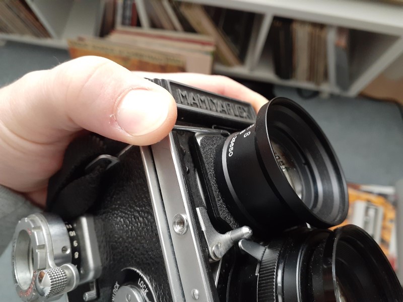

I had to file down a corner of the lens board on my black 80mm lens that I use on a C2 to allow the retaining bar to fit properly. I'm not sure if you would have to do that with the 65mm as well.
You should not need to do that.
Right, I shouldn't, but had to. The thickness of the lensboard prevented me from securing the bar and filing it down created enough clearance. Older lenses have a stamped lensboard so this isn't an issue. It also isn't an issue on my black 65mm - can't remember if it is a stamped lensboard or not. In the photo, I'm holding the bar where it enters the lock slot to show that it just clears the lensboard with it filed down.

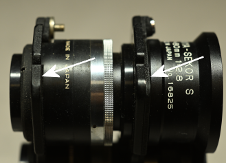

Most of the C series lenses will fit the C2 but as previously noted, the 80mm S lens (and also two of the 105mm versions), have slightly thicker cover plates due to the different flash sync socket style and the fact that the C2 lens lock spring latches on the left side of the camera while the later models have a right side latch so more flex in the lock spring. So these lenses would need some modification to work. The photo shows the standard lens board on most of the lenses (left) and the lens board with thicker cover plate on the 80mm S lens on the right.

I had always thought all Mamiya Cxxx equipment was completely interchangeable.
Carlini Fotograf
Jun 17, 2013
32
Detroit
Most of the lenses are.. I have a C2 and C220. I have the black (blue dot) 65mm and most times its on my C2 and it fits perfect. I also have
an 80mm f/2.8 S and that's mostly on my C220. I also have the 105mm f/3.5 S and they all work on both cameras.
I might buy a 135mm MX too from someone I know that has a mint one for cheap.
I think there is just a couple of the later black lenses that were made specific for the C330 and C330f that wont fit on the other C cameras.
I dont know which ones they are though...
