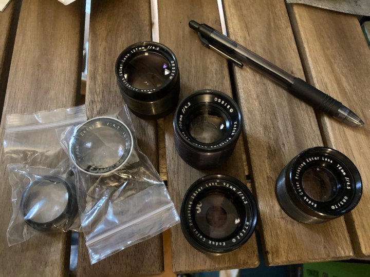

Small update
I've gathered some lenses, I'm going to experiment with coverage and adapting them to shutters. These weren't really on my first list but I got some really favorable deals on ebay. 4 kodak printing ektars, 1 kodak 127mm 4.7 which I think came with Speed Graphics. This one was lens cells only, but just $25 and since I need 2 I jumped on it.
My plan is to figure out which lenses fit what shutters, any info here would be appreciated. Then I'm going to look around for some kodak printing lenses with adjustable apertures for the taking lens, remove the aperture disk from the viewing lens.
I forgot to ask in my last post, will c-mount lenses cover 6x6? I thought their coverage was much smaller.
I hope everyone's projects are going well!
-John
