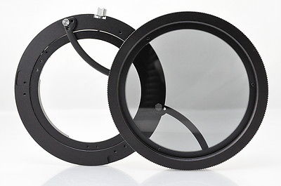

I can use and see the effects of filters with a Pentax, can't with the Mamiya - especially a polarizer.
There actually is a Mamiya 7 polarizer, and it's easy to see the effect. Graduated ND filters, on the other hand, are a bit of a challenge, but manageable if you use Lee's system to estimate placement.
