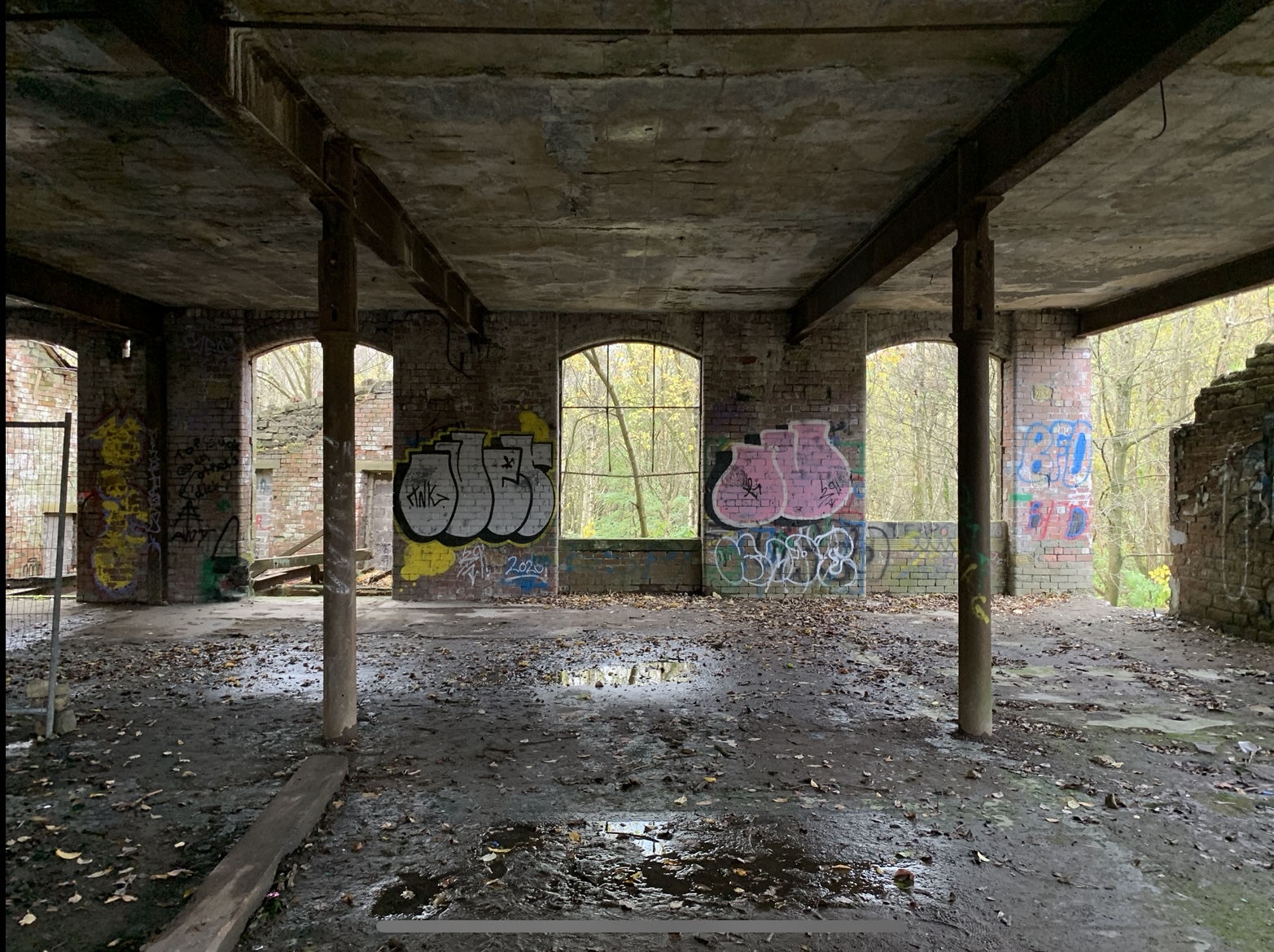

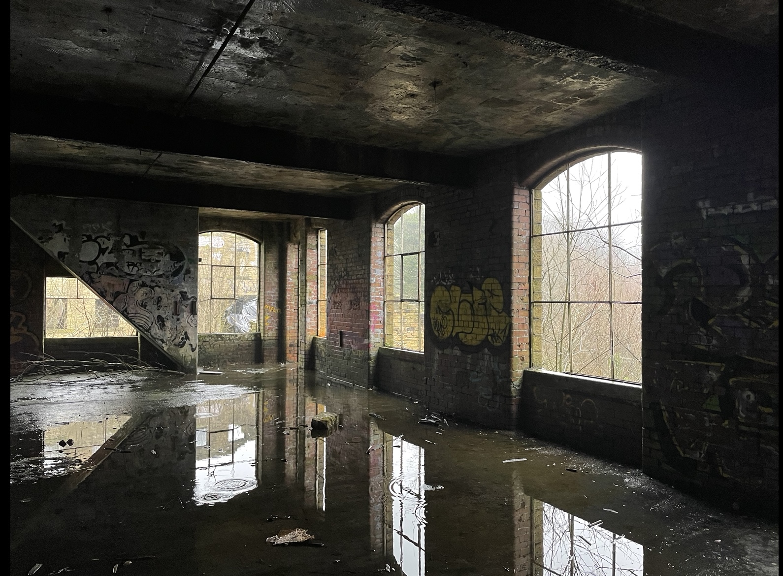

So would you use incident for this scene?
See attached.
cheers

Chris, in all honesty, if you can meter for portraits, then you can meter just about anything!

Another ref shot from the other day. It was lighter then.
