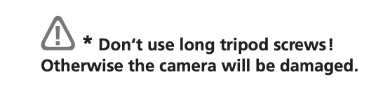

Super8
Use a shorter screw, or put a washer under the screw head so it doesn't push into the body. Putting the washer between the plate and the body just makes it easier for the camera to unintentionally rotate on the mounting plate. The original Rollei Hy6 autofocus would malfunction if the tripod mounting screw was too long and pushed the body against the cameras internal circuitry.

If you're having this issue and your local hardware spot cannot get you a shorter screw that is appropriate, get some type of washers in there as spacers. Or, as 250swb says, file some length off of that screw.

Yes sorry for the delay. Just needed a shorter screw.
