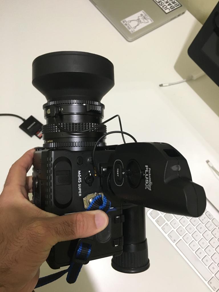

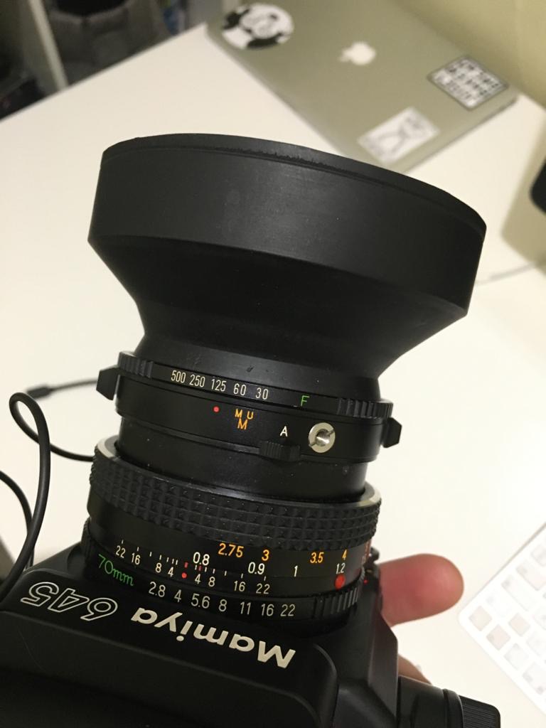

Hello, new here! I own a Mamiya 645 Super with a Sekor 70mm leaf shutter lens, but I’m puzzled when trying to pair it with a strobe.
When doing so I’m setting the camera s/s to 1/8 or less, connecting one Pocket Wizard to the X Sync port on the lens and the other one on my Godox Ad 200. When ready trigger from the camera.

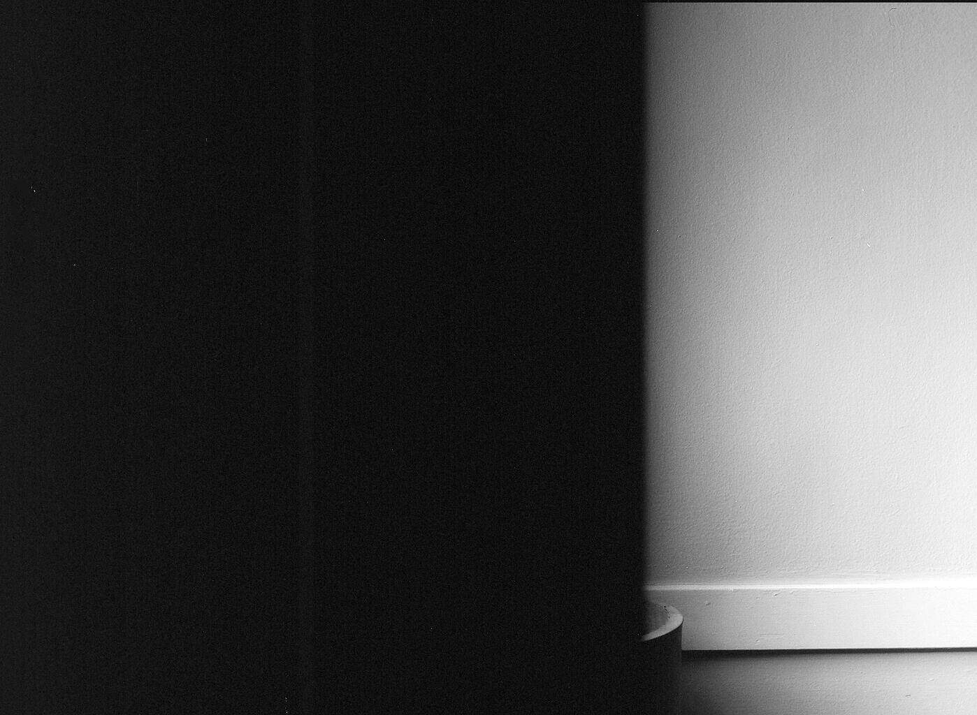

Thank you :smile: see a photo attached for the photo results I get… what I mean when I say I set the camera shutter speed to 1/8 I mean I turn the know on the camera to 1/8 and in my head by doing so telling the camera to use the shutter speed dictated by the leaf shutter lens… am I doing it wrong?

There is at least a chance that your camera's focal plane shutter needs some service, because when you set it to 1/8, you are getting something of shorter duration.
Try it at 1/2 second.
Can you fire the flash directly from the lens PC socket? That would help eliminate the remote trigger from the equation.
One further thought - given the age of the Mamiya 645 70mm leaf shutter lens (which I once owned), is there a choice of X and M synchronization on that lens' shutter?

Yep I'm starting to think it might need some service given that I bought it used and don't know much… any leads where to in the SF/CA are would be appreciated… but at the same time, when I shot a roll 1 month ago, on 15 photos one turned out good… so I assume the camera does work, I'm setting something up wrongly.
I think I'll try to "waste" a roll doing some test, starting to shoot in Bulb Mode (B) and going up to 60… hopefully, this will expose the problem.
