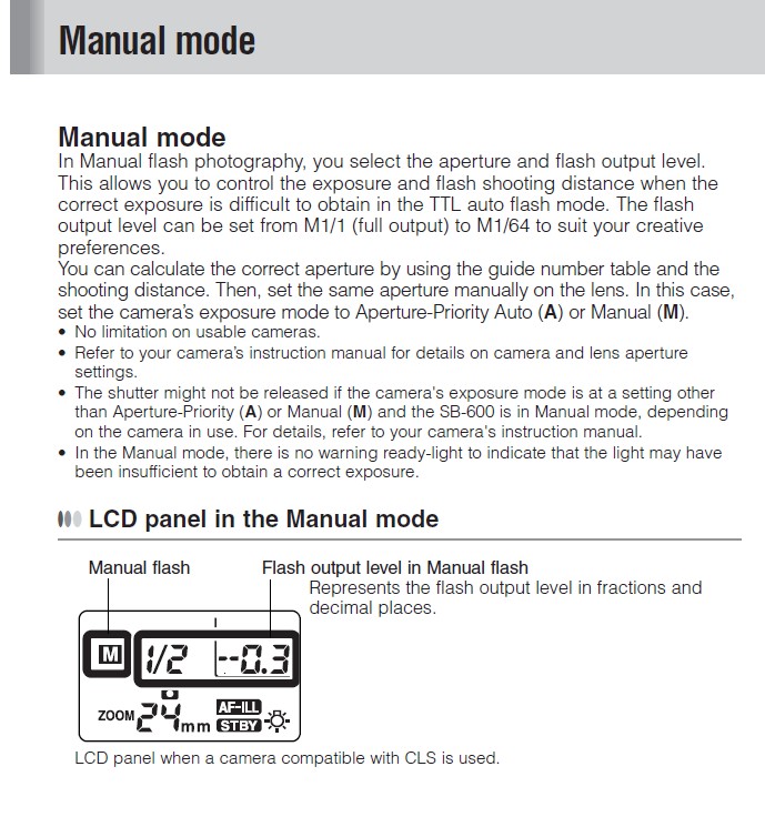

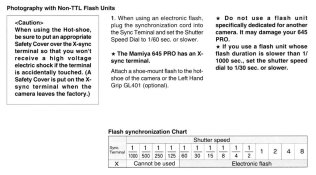

This sounds like it should work, but with shutter speed at 1/60 or slower. I have a Pro TL on the way, and also have an SB-600. The SB600 manual says it has "no limitations" in manual mode, whatever that means. Hmm..... I doubt it would hurt the SB600 in manual mode, but we can flip a coin to see which of us tries it first and maybe fries his camera. :laugh:
And according to these folks, it will work... http://photo.net/medium-format-photography-forum/00QMl6
It's info from the internet, so it must be true, right?

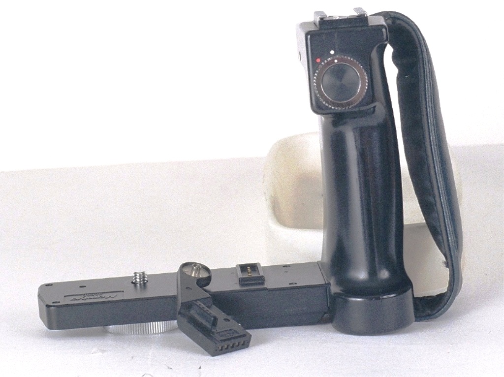

I use a variety of different flashes with my Mamiya 645 Pro. I have a leaf shutter lens, and I have used it with some of those flashes.
The hot shoe on the side of the camera isn't really suitable for mounting the flash. The geometry would result in a flash putting too much strain on the shoe, unless you used the camera turned sideways at all times. The shoe is actually designed for connecting something like a corded connection for an off camera flash.
There is a grip that works with the 645 Pro, and it is not the grip that works with the RB-67/C330. That grip's trigger actuator won't connect physically with the camera's shutter release - the geometry is close, but not quite.
The correct grip is the one pictured below. It has an electronic shutter release and a working hot shoe, as long as it is used with the correct connector (the connector for the Pro is different than the one for the Super). The hot shoe will only help you though if you are using the focal plane shutter. If you want to use the leaf shutter, you need to use a pc to hot shoe adapter mounted on the grip (the SB600 doesn't appear to have a pc cord option).
If you want a rotating flash, you could try a grip like the one pictured here:
http://cgi.ebay.ca/ws/eBayISAPI.dll?ViewItem&item=110387940314&ssPageName=STRK:MEWAX:IT
Hope this helps.
