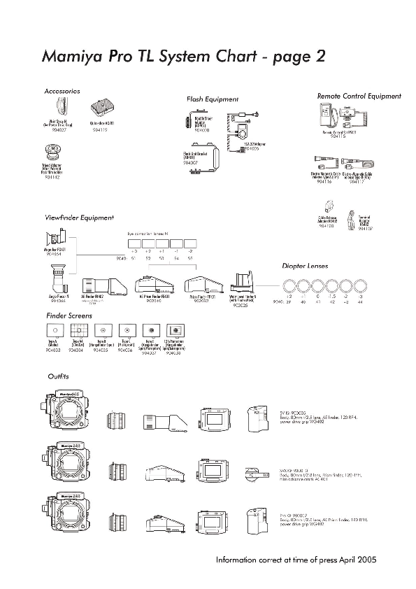

There are many different finders. Thanks to Mike Butkus' site, here is the system chart for your 645 Super: http://www.cameramanuals.org/mamiya_pdf/mamiya_m645_super_system_chart.pdf
And again thanks to Mike Butkus' site, here is the system chart for the 645 Pro/Pro Tl:

Mamiya made two finders without the diopter adjustment. Both were true prism finders and were not as large as the one you have. One was the AE finder, and the other was identical to the AE finder except it had no meter. The non-meter version is what I have. I bought my 645 Super new when I was in high school, and the AE finder was extremely expensive back then. Couldn't afford it, and I had a good handheld meter, so didn't need it. Now, the AE finder is cheap used. I don't think you can turn the meter off, but you can shoot in manual exposure mode and ignore the meter.

You may also want to keep your eyes out for one of the waist level finders as well. They're 'a little different' than what you are probably accustomed to, but they can really change up the feel of working with the camera. Some people love working with them, others hate it. The left-right image flipping is not the most user friendly option or the easiest to get the hang of for many people, but people who do like them can be rather fond of them I've found. Worth trying at least.
