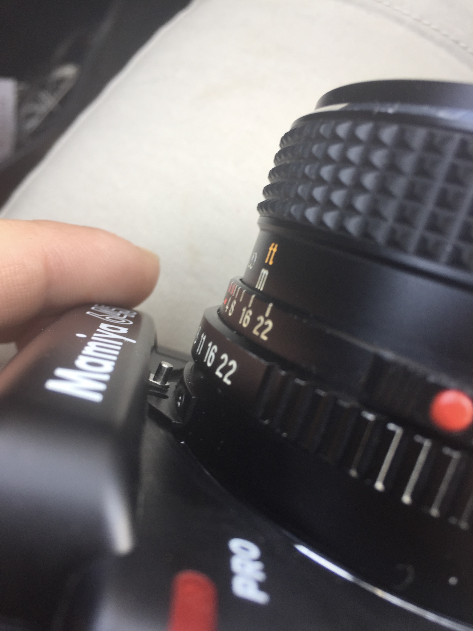

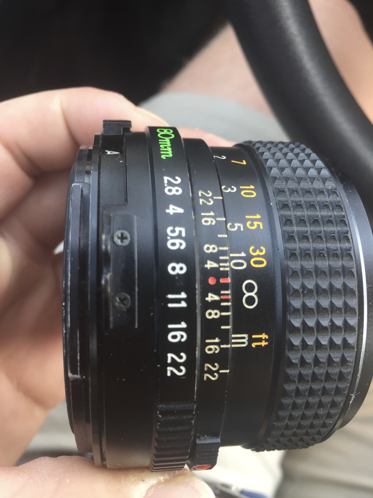

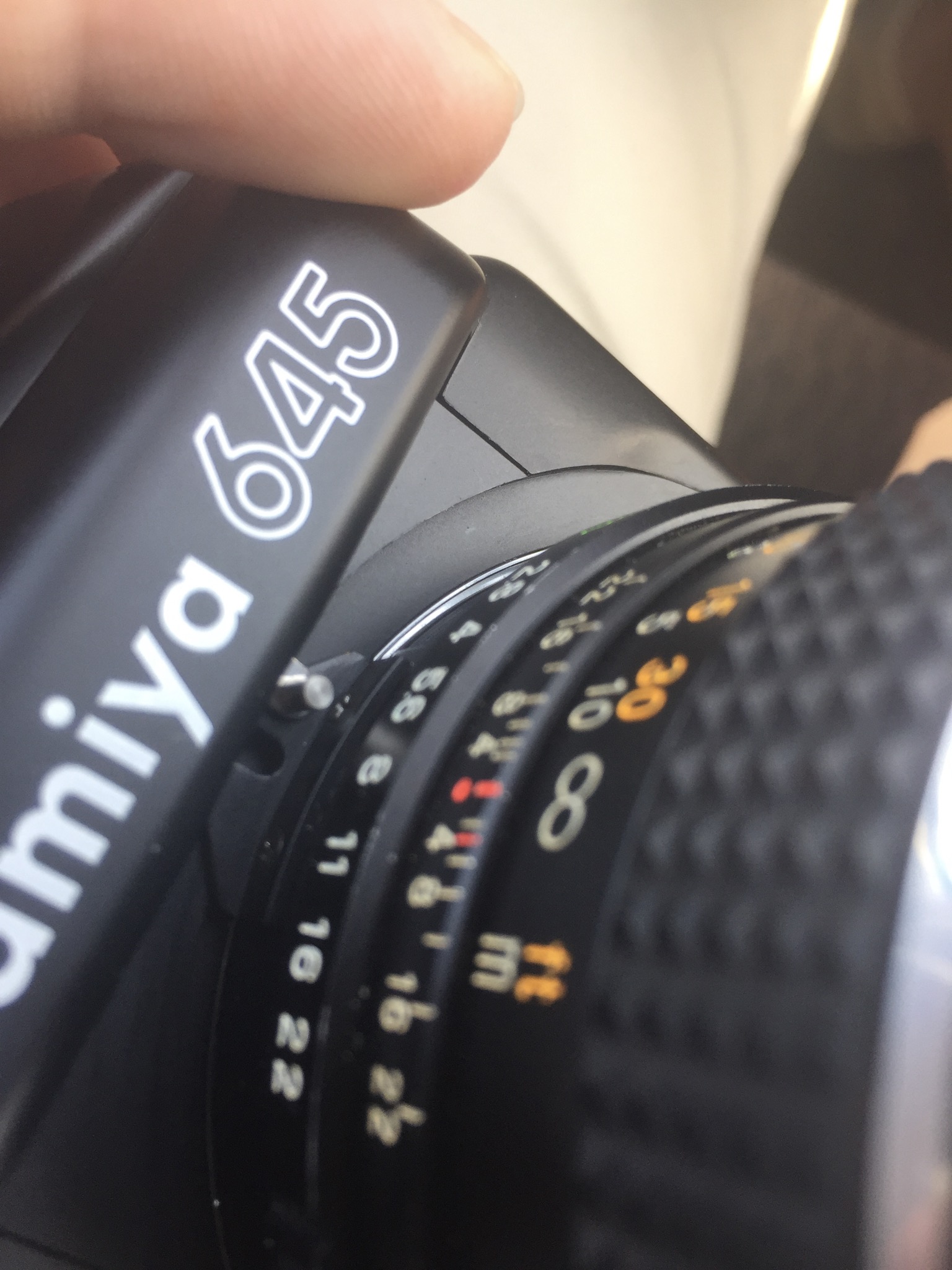

The "bunny ears" rest along the body and I feel like they shouldn't be touching the body.

Your lens is a 'C' series (the later CN had fixed rabbit ears without the screws), the rabbit ears are definitely the wrong way round - they should line-up with the front (closest to the front element) of the A/M switch (i.e. the rabbit ears should be between the two screws and the aperture ring - not behind them both).
Looks like somebody has fiddled with the lens at some point, but it looks like the body might be OK.

i dont work on that camera, but looking at your pictures, it seems that bracket held on by 2 screws just has to be turned around so that arm from the body can properly align in that groove.
