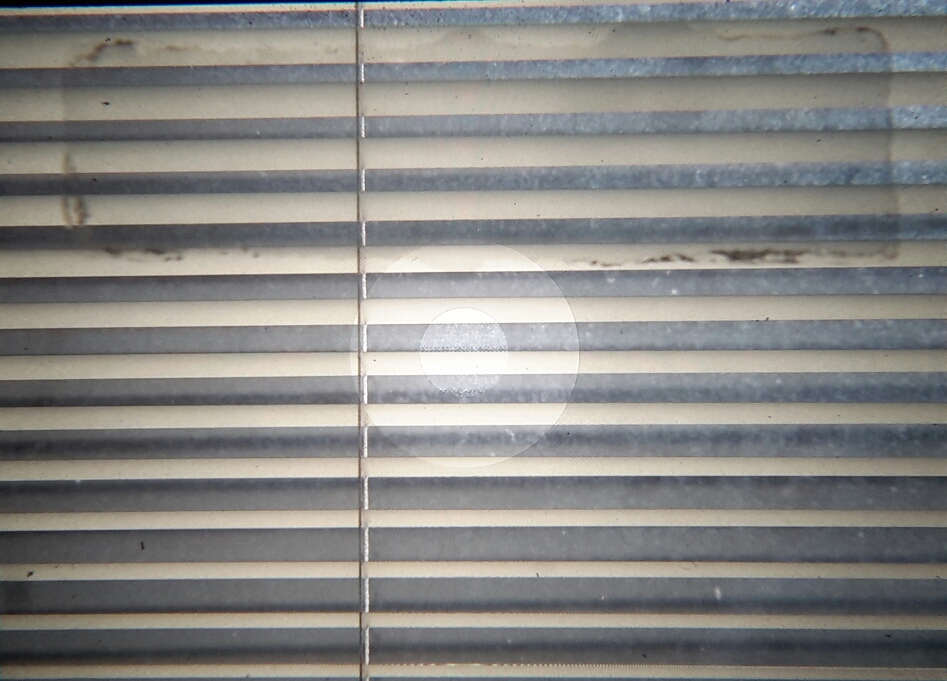

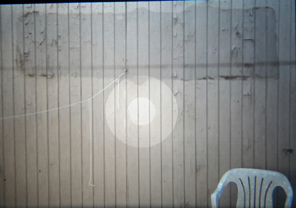

Here's what it looks like. A heck of a lot better than a big, grody spot in the center of the view. The blending at the bottom isn't perfect but I think that could be remedied by rotating 180 degrees between coats. The thin, horizontal line thru the middle is a mystery. I don't think it was there before, but maybe I just didn't notice.
Here is another that shows the blending better.
