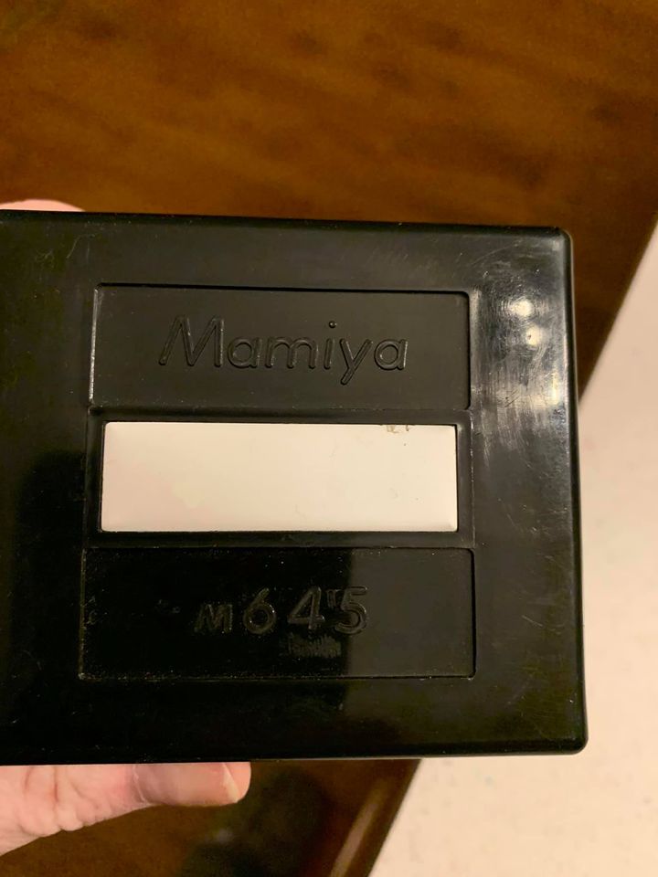

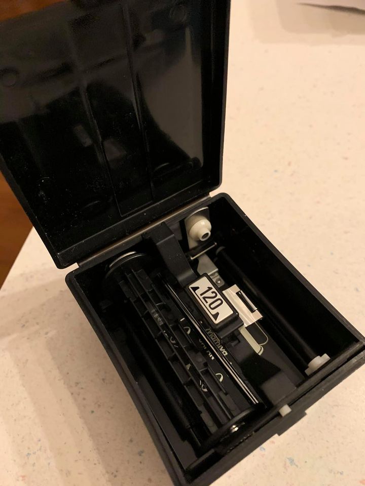

Are all the Mamiya 645 film backs interchangeable? I have a 1000s and want to make sure this back will fit. Thanks in advance for any assistance.
spijker
Mar 20, 2007
626
Ottawa, Canada
What you show is an insert, not a back. According to this wikipedia article, the inserts are universal for the manual focus series. So an insert from a separate back should fit a camera with a non-removable back like the 1000s and vice versa. So you should be fine with the insert shown on the photos.
Just make sure that the knob in the middle has "120" on it. If it has "645" or "AFDIII" on it, it is an insert for the AF (autofocus) series. Those do not fit the cameras and backs of the manual focus series (I just tried).
