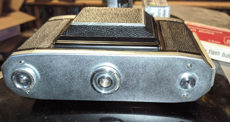

Finished the first (test) roll today, went to unload the camera -- and found one of the knobs you pull down to disengage the pin from the spool had fallen off. This camera didn't come with a case of its own, and the knob isn't in the camera bag I've been carrying the camera in, or, as far as I can tell, in my car (though a car is difficult to search effectively for a small part, especially a non-magnetic one). The two knobs are the same -- verified by unscrewing the supply side knob and temporarily installing it in the takeup side to let me unload the exposed film. I'm not very interested in paying $90 including shipping for a parts camera.
Presuming I don't find the knob (if it came off at work, it's gone; the lunchroom, shop, and warehouse will have been swept/mopped by the time I get in on Monday), does anyone happen to have a spare off a non-functional camera, or know the correct thread? Presumably metric, fine pitch, but I can solder up a usable knob from a brass screw and a couple washers, if necessary -- and if no one happens to know, I can apply magnification and count the thread myself.

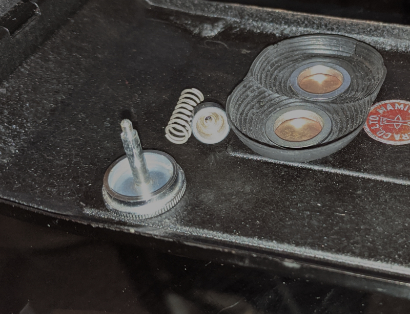

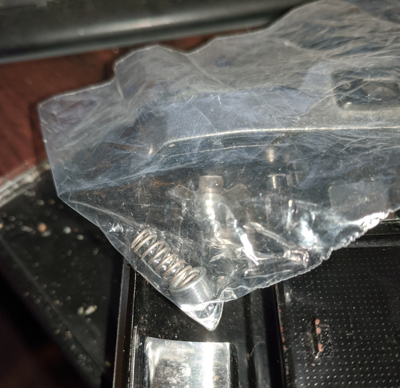

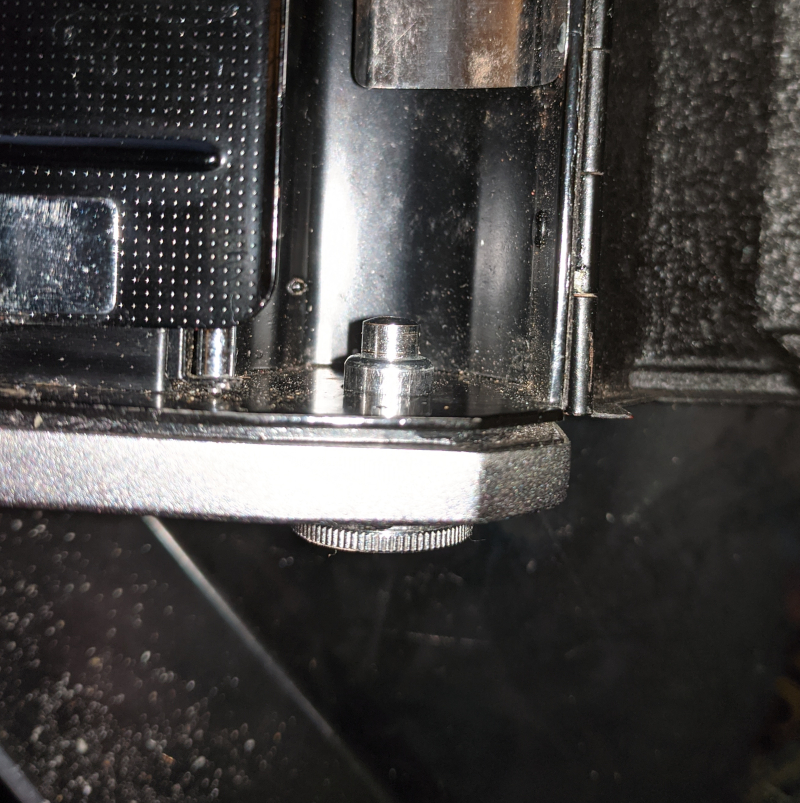

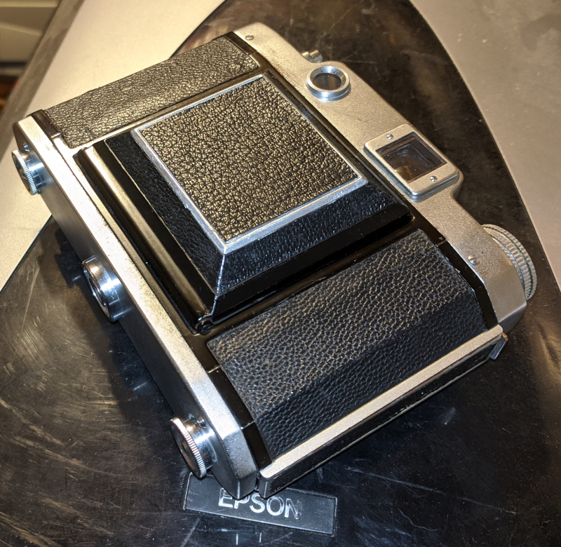

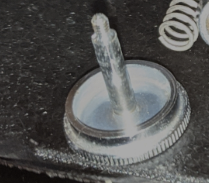

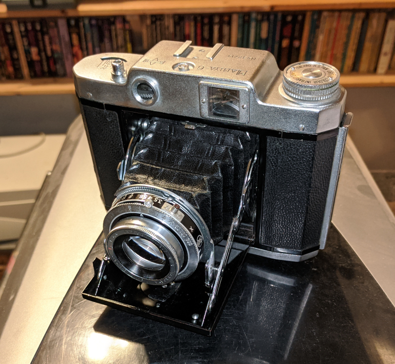

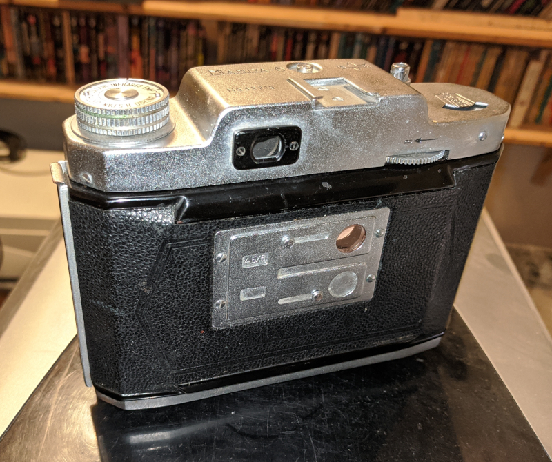

Okay, here are photos previously requested (finally had time to upload from my phone to Dropbox, open in GIMP, crop, resize, and save back to Dropbox).
The camera as I received it:
And the missing knob and remaining (identical) one.
IMG_20201128_152342.jpg IMG_20201128_152430.jpg IMG_20201128_153818.jpg IMG_20201128_152448.jpg
Bottom of the camera showing where the missing knob should be; inside parts (in a bag so they won't get lost), remaining knob showing light trap cup, shaft, threads, spring and inside pin, and remaining knob in working position.

Go to the hardware store and find a metric bolt that fits? Looks like 4mm, but maybe not. Hard to know what else you would need without the camera in front of me, but I'm sure you can figure it out.
Donald Qualls
Donald Qualls
Jan 19, 2005
12,544
North Carolina
At work, I'd call it a "shoulder screw" -- the thread is smaller diameter than the shank, and the shoulder screws tight against the inside of the cup in the inside pin. This and the cupped knob are light trapping features. I could load film by removing the knob from one side, loosely screwing in on the other, installing the takeup spool, then swapping the knob back to the supply side (tight, so it won't come out and get lost, too), loading and away I go -- but with the knob missing, there's a direct path for light to the interior of the spool. It might still be adequately trapped to avoid fogging (likely would be), but it would also take ten minutes or so to change film and the constant loosening and tightening of the knob could/would result in marring the pin on the supply side from gripping with pliers to get enough torque.
If I had my lathe set up, I could turn a near-exact replacement, but I don't have room to set up and operate my lathe or unpack the rest of the related tools -- and threading to a shoulder is prone to mistakes resulting in "start over". Not even to mention the fun times cutting a metric thread on a lathe with US thread lead screw.
Finding a (probably) 2mm screw long enough is very unlikely; I'd have to cut a longer screw, solder up bits of brass tube (if I can find any close to the right size) to center and solder in the screw, then solder up pieces to make the knob. Not impossible, and I'll pursue that option if I can't find a replacement, but getting the correct part would be much preferred.
I may try contacting the seller in Japan to see if he has any spares he'd sell me...
