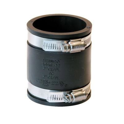

I don't think you even have to strip it down too far to just swap the elements. RB fronts usually screw out once the name-ring is removed, though it may be easier to remove the metal surround (three screws on most lenses); the rear may just come out with a spanner wrench. This varies from lens to lens, but I just cleaned a 65 and had both groups out in about a minute. Swapping 65 elements would have taken about 2 minutes.
To get the name ring off, I use a "fernco" plumbing adapter, they have one that's the perfect size, available at any hardware store for a couple bucks.

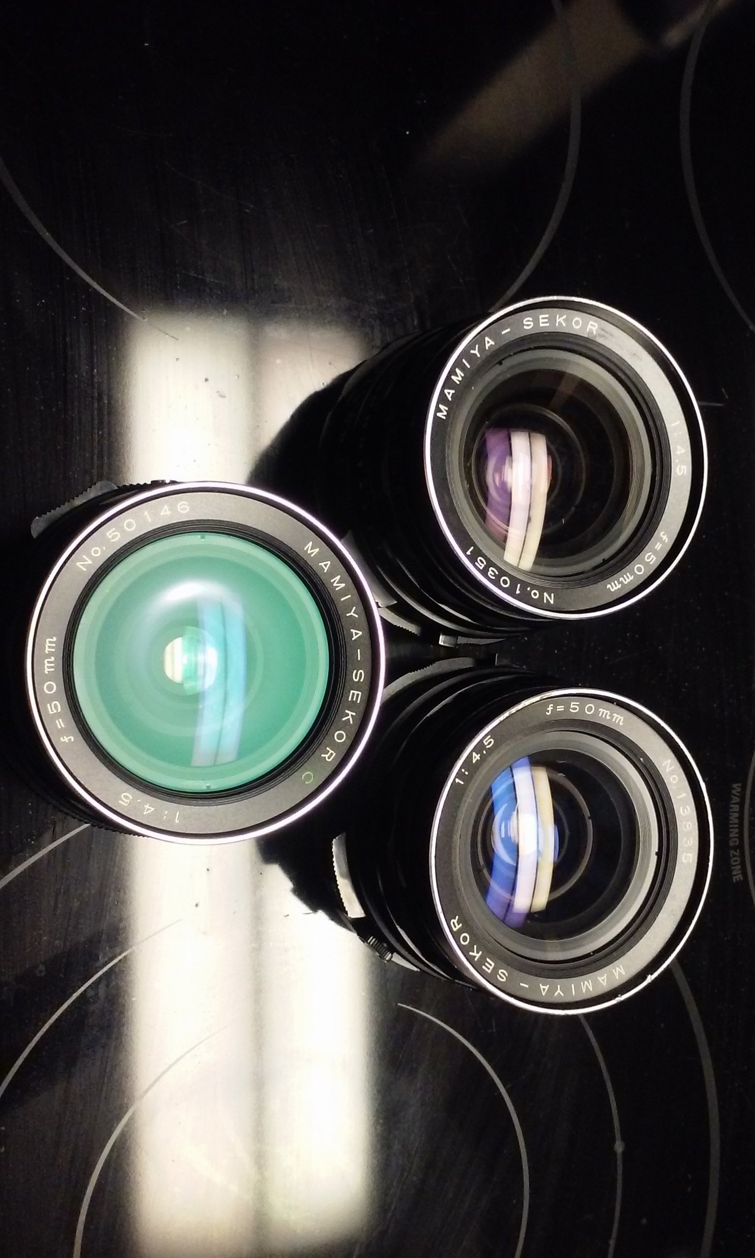

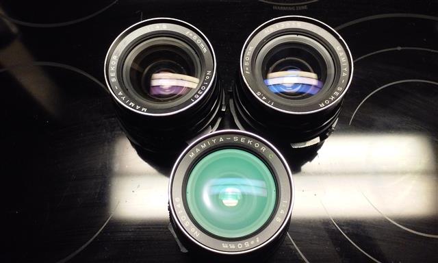

Yup, and yup.
These are crappy cell phone pics of my 3 50mm's; C, and 2 non-C

You can easily the different coating on the C lens, the C also has an improved PC socket, and a different baffle (?) at the rear of the lens.

Wow...
I like the 50/4.5 lenses, but it seems you like them too much!! :wink:
The difference in coatings is visible. But does the "C" version really looks better through the viewfinder?
Also, the non-C lenses seem to have different coatings, or is this due to the angle?

Not sure on the 2 non-C's. I didn't notice that, but I'll check later and let you know.
It's not that I like them so much (i do like them tho), it's just I got a deal on a box of RB stuff. The C and one of the non-C's were in the box, along with a 90mm, a motor back, and a 220 back. And some other assorted stuff.
