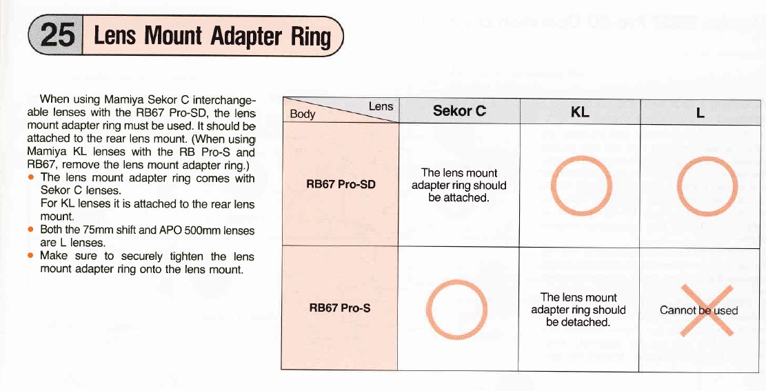

Mamiya 50mm 4.5 Sekor C fits the Mamiya RB67 Pro SD but not the Pro S? Help please

No. You need to remove the ring on the back of your lens. It is held on by friction.
Thank you! So my lens right now has a ring (adapter) fit on the back which it allows the lens to mount to the SD camera...and when I remove the ring, the lens will now fit the smaller Pro S ? Is that correct?
I appreciate your help. Dan

Just found this... thanks again.
Dan
