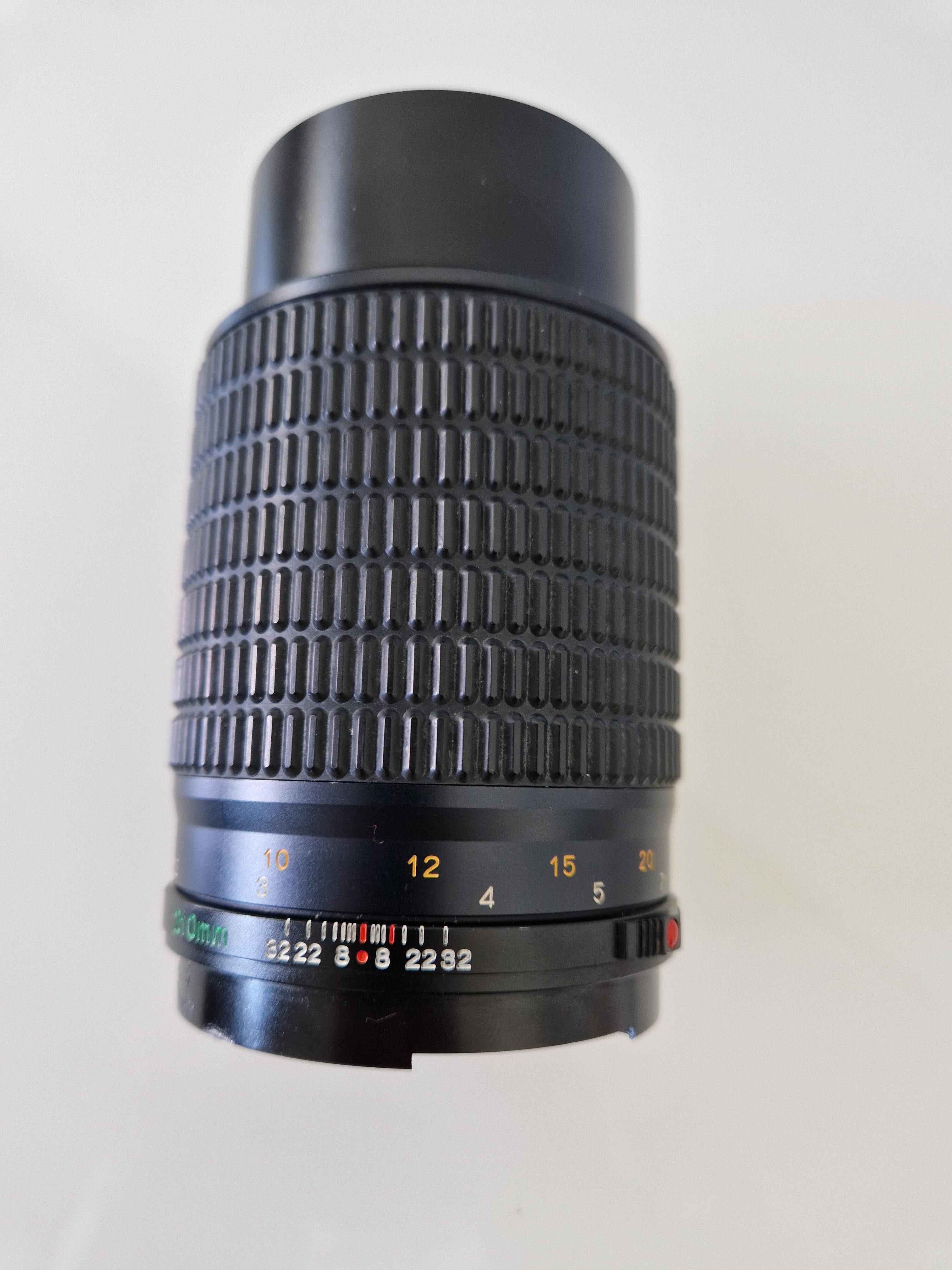

Hi. did you get to fix this issue? I just bought this lens "as-is" and it has exactly the same problem. I've been looking around for some repair instructions and this is the only thread I see.
I've disassembled most of the lens, but I still have the barrel + the "free-floating" focus ring. I don't see any more screws to take out.
If you remember the steps you took, please give some instructions on how to get it fixed. thank you
I don't know this lens in particular, but based on other lenses and what other people said in the thread: You probably have to remove the rubber focusing ring. You do this as described above, by carefully working a thin screwdriver under the rubber ring to remove it without tearing it. After that, you are likely to discover small screws under the rubber. Often these small screws locate the outer metal ring with respect to an inner body. If the focusing helicoid became stiff due to dried out grease, it is possible that someone turned it hard enough to drag the screws and outer ring out of position, so the outer ring is no longer turning the inner part.
If the above ^^ is the case, then you should really service (or have serviced) the helicoid or you will eventually strip-out the screw indentations due to the high friction in the focus ring.
