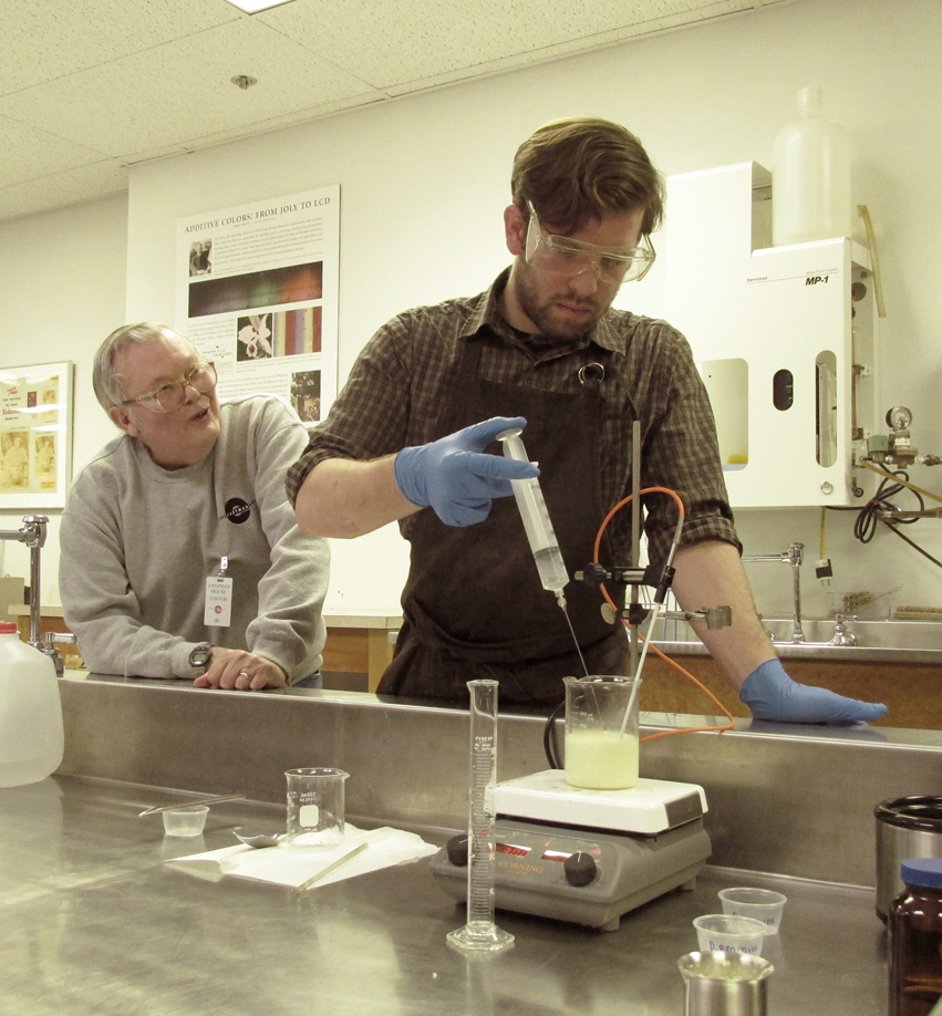

Each four day workshop when like this. With the help of volunteer research assistants Nick Brandreth and Chris Holmquist and my good friend Ron Mowrey, we demonstrated how to make an actual emulsion with the lights on so that it was easier for the class to see and also to take reference pictures. We then divided the class into two groups that made their own emulsions in separate darkrooms with the help of Nick/Ron and Dave/me. After the first day we had our emulsions, which were noodled and washed the next morning.
