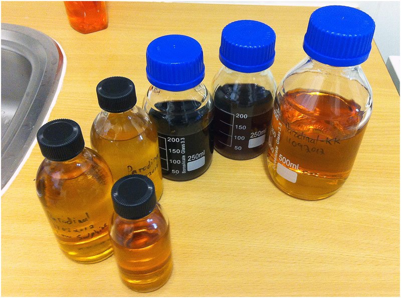

Here is a pic of the two solutions from Monday:
Now, the observations on Monday Aug 27th:
Parodinal Batch 25082012-01: Dark red probably due oxidation in bottle. Solution had longish crystals amongst the sulphite sediment.
Parodinal Batch 25082012-02: Colour not determined, but it certainly didn't seem darker than on Saturday. Many long crystals had formed at the base, and solution was clear. (Sunday evening showed no signs of any crystals!)
On Monday afternoon, I was annoyed by seeing so many crystals in Parodinal Batch 25082012-02:, so I emptied the bottle into a small measuring jug, and slowly added up to a total of 7gr NaOH, which slowly dissolved the crystals, but a new sediment formed soon after which resembled that of a saturated sulphite solution. The solution was put back into the amber bottle. Please don't ask me why I added the extra NaOH :tongue: I though it was a good idea at the time. I have probably ruined a good thing here...
The observations on Tuesday morning Aug 28th:
Parodinal Batch 25082012-01: Crystals seem unchanged, but solution seemed a little darker
Parodinal Batch 25082012-02: The base of the bottle was now full of long crystals again. Solution colour unchanged and still clear.
Dead Link Removed
Parodinal Batch 27082012-01: No crystals yet. Solution is a clear amber colour with very feint and very little sediment.
Parodinal Batch 27082012-02: No crystals yet. Solution is a clear, slightly yellow in colour, with very feint and very little sediment, but a little more than Parodinal Batch 27082012-01:

What do refer to as excessive? Can you post a picture of a bottle with crystal deposits in?

It's the last image in my initial post, but here it is again.
hard to see, but they occupy a large volume of the bottle

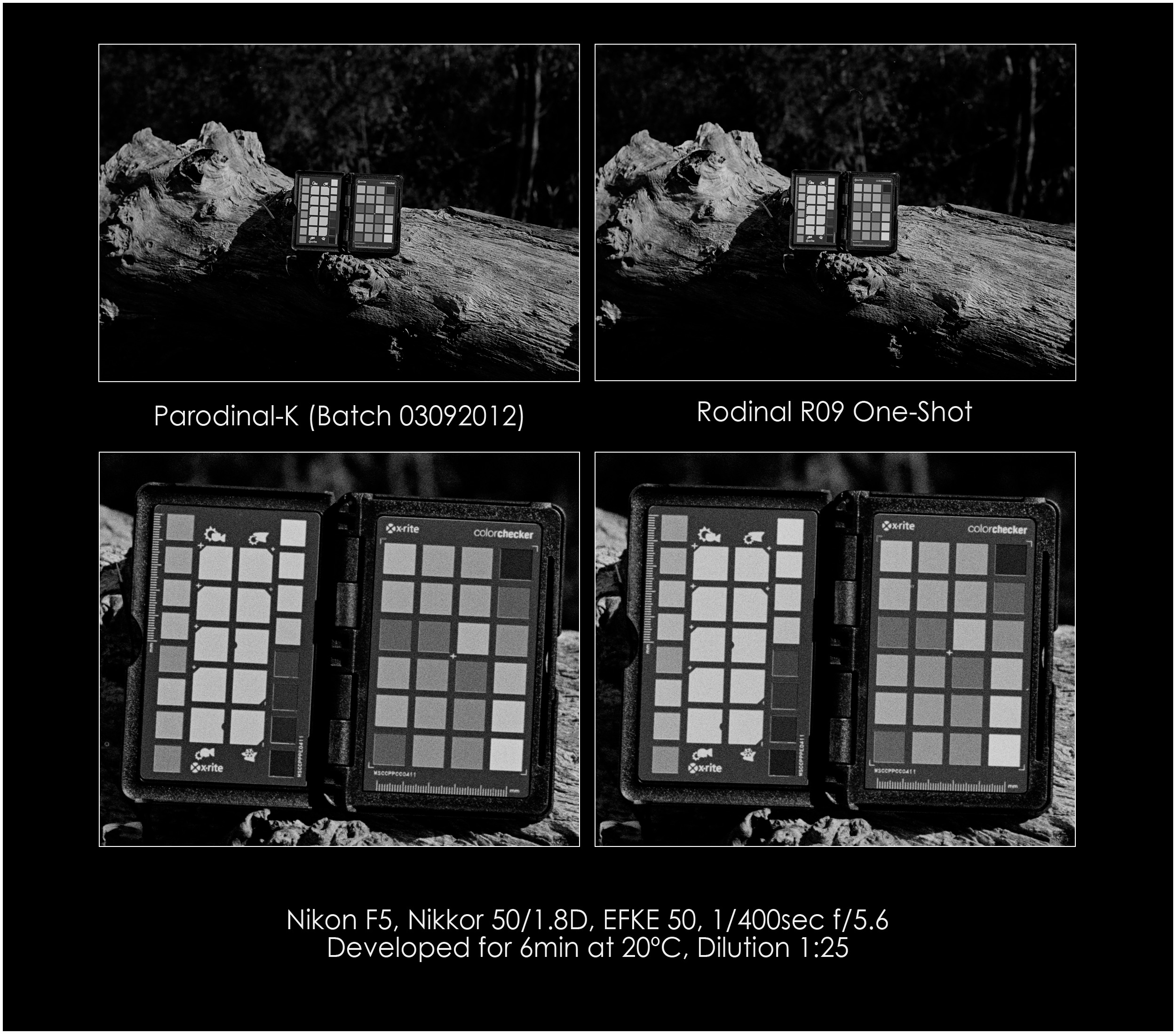

Here is a comparison image of commercial Rodinal R09 One-Shot (Purchased from MACO) and Parodinal Batch 27082012-2. (Link to the full res version is HERE)
Interestingly enough, the Parodinal developer created ever so slightly denser negatives, which is something I only noticed after scanning.
The negs were scanned on my Imacon 343. The film was EFKE 50, shot with Nikon F5 and 50/1.8D, exposed at 1/400sec f/5.6 as per incident meter reading, and developed in dilution 1:25 for 6min at 20ºC.
Apologies for the dark negs, I don't work with this film very often, so film speed rating developing times are taken using recommendation by massive dev.
Please note, these images come straight out the scanner, with only cropping applied. Sharpening was set to zero, and levels were kept as is at 0, 1.0, and 255.

Looking at the full res images it's hard to tell them apart.

I developed a roll of film yesterday with monday's Parodinal batch 27082012-02 (The clear one)
At the time of opening, it was still clear, but more yellow in colour. After developing, the first crystals started appearing, and by this morning the colour is slightly pink-ish.
Here is another scan comparing it to the Rodinal R09 One-Shot I have:
The full res version is available for download HERE
With thanks to Jaco, I will be changing the formula and will be using KOH instead of NOH. Also, I will give a go at using a Potassium Metabisulphite based formula, just to feed my curiosity. I will continue with the scanned comparisons once those solutions are ready for use! Hopefully by monday I will have made these new batches!

So, to get everything up to speed...
I've made a few batches of Jaco's formula, and am very pleased with the results. There has consequently been a lot of email correspondence since.
The current Parodinal family:
On the left (they yellow/amber colour solutions) are my early batches I made when I started this thread.
Batches 25082012-01 (the small bottle), and batches 27082012-01 and 02
In the middle, the two 250ml blue capped bottles, are batches I made with Jaco's recipe. Batches 03092012 and 07092012.
Batch 03092012 was made with 10% extra KOH, since the technical grade KOH had a minimum ASSAY of 89,5%.
After making this, Jaco assured me that the 10% compensation was too much, and that his recipe would have sufficient KOH required.
This lead me to make batch 07092012, which was made as instructed. I still haven't tested this batch
Of the two, I have only developed film with batch 03092012, which worked as advertised. (See comparison bellow)
The large bottle on the right is Batch 11092012, which was made with KOH + K2S2O5. This stuff needs to cure for two more days before I can test it.
All in all, I'm incredibly happy about the very clean and clear end product. So many thanks Jaco!
