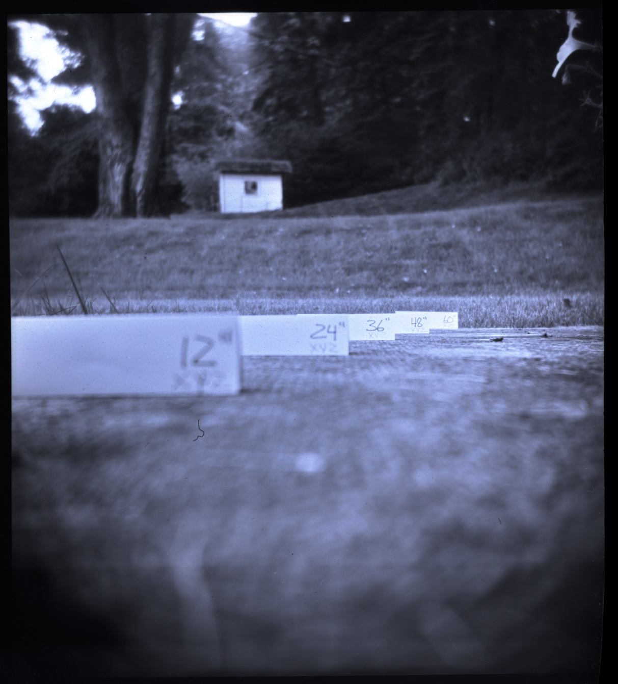

Here I clipped a piece to test the close focus of a camera I have. This was developed in Perceptol 1+1 for 3 minutes (room temperature). The highlights still went pretty fast, but there is some shadow detail and a good range of midtones -- to my eyes anyway. Scanned raw, no corrections, just inverted.
I'm still looking for other examples I have.
