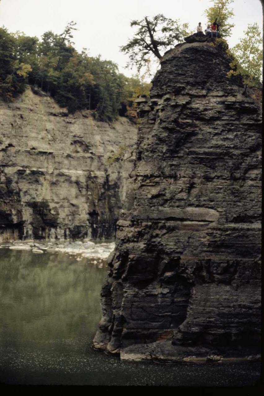

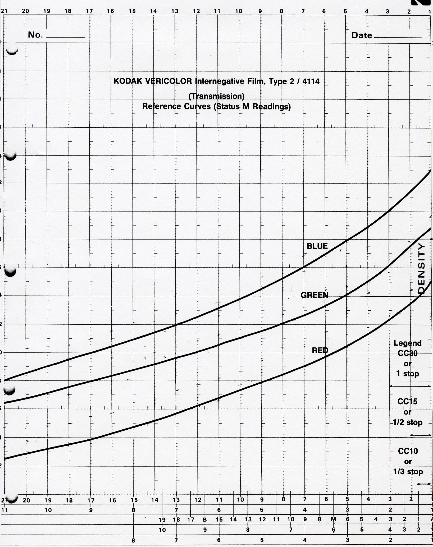

Here are the curves of the "real" internegative film. If you do not balance and expose properly, you get crossover due to the upsweep on the right of the curve. Regular Portra has no upsweep, but is straight with a shoulder and that is why use a just a tad of pull process. Stay off the shoulder of Portra 160.
The left photo "Birds of a Feather" was made on Portra from a 35mm Kodachrome, and the right one "Tower Rock" was made from an Ektachrome original. Both are about 2" x 3" on 4x5 Portra and used the exposure and process described above. The photos strained the upload, but I made it. The Kodachrome is just too contrasty for me. No Kodachrome has turned out as well as I wanted, but the Ektachromes were just fine.
