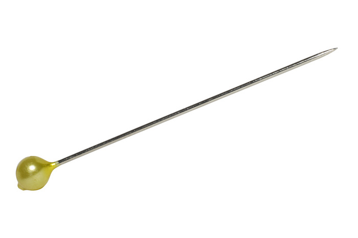

"What pins were you using?"
Pins in my registration pad a ordinary household pins like this:
I cut them to about 12 mm (1/2 of inch) and hold them in a pad using epoxy glue.
