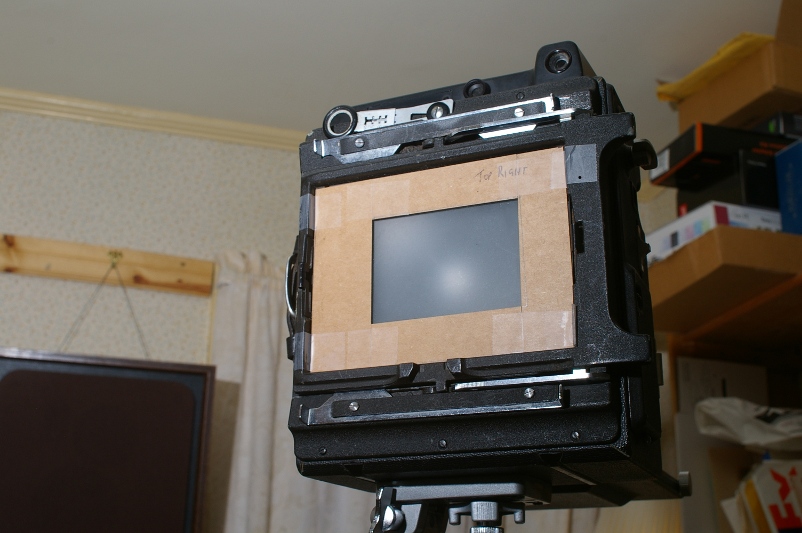

6 x9 version of thin cardboard and magic tape
