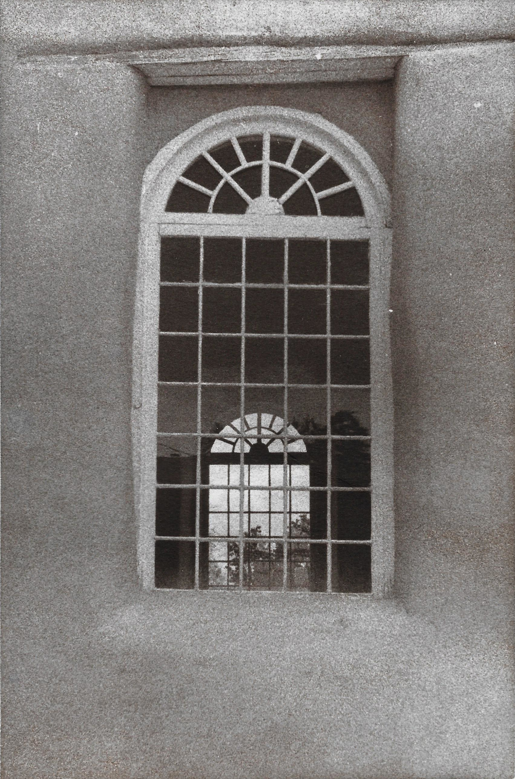

I've made enlarged negs from 35mm film using Aristo Ortho Litho film. I used flashing and reversal processing. A good reference for this:
I found that some of this PDF is based on assumptions about your negatives that might not apply, so I had to use a different calibration method.
Here is a platinum-toned VDB made this way:
I've also printed using digital negatives. The learning curve is about the same, and the results are similar when everything goes well. The main advantage with digital negs is consistency. That's a great help with carbon, where it takes significant time to redo a print that wasn't right.
