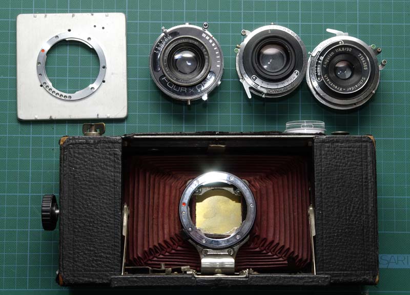

paul ewins
Jan 5, 2006
446
Melbourne, A
Something like this then.....
Basically, a piece of aluminium with a copal 0 size hole is screwed to an old lens mount. The lens is then attached in the normal way. I've got a 150 G Claron, 105 Leitmeyer and 90 Angulon mounted this way.
The body mount is best done by using a short extension tube as this gives you the little lever and pin to hold the lens in place.

Dan Fromm
Mar 23, 2005
6,933
Fine, wonderful, but your folder has a fixed back. This raises two questions.
I can see you to set the thing up to focus one lens. What will you do with another lens with a different focal length? Focusing on a ground glass doesn't seem possible.
And what will you do with a lens whose rear cell's outer diameter exceeds the K-mount's inner diameter? Again, unless you set up to shoot a whole roll of film with the lens, the old unscrew the rear cell and reattach after the shutter/front cell is mounted trick won't work.
Ian Grant
Ian Grant
Aug 2, 2004
23,419
West Midland
Dan, all my modern LF lenses for my 5x4 and 9x12 will fit the rear cells through a Pentax K-mount, even my Rodenstock 90mm f6.8 Grandagon. Also all my German vintage lenses in Compur shutters, the only lenses I have that think won't fit are Illex Paragons.
