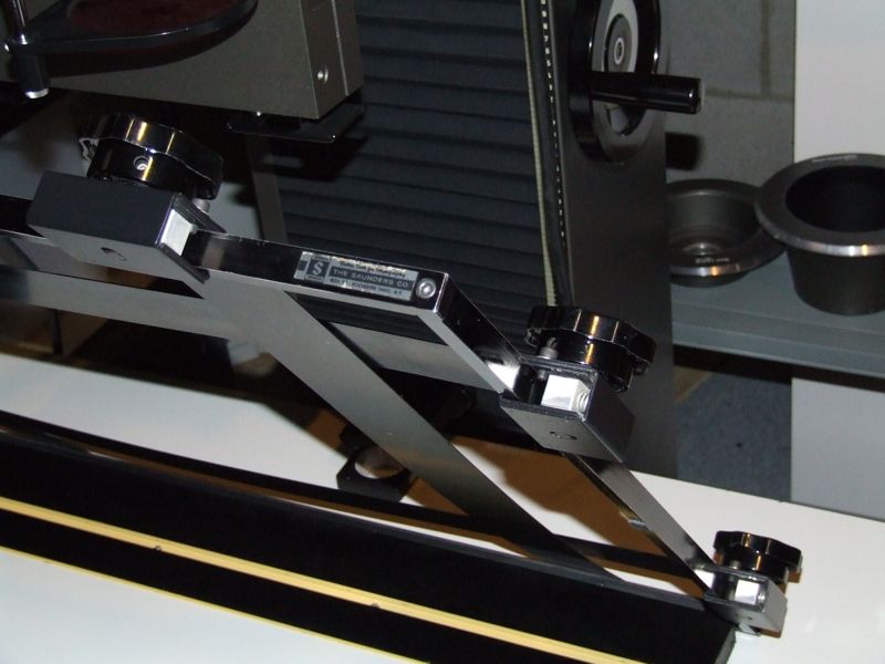

I have always held the contention that when making something, you should get raw materials that are as close to the intended size and shape as you can. This makes fabrication and construction easier. In this case I found a collection of parts that were already in the rough shape of a 4-blade easel:

A few more pictures showing gummed up rollers and a very bent stay-arm:

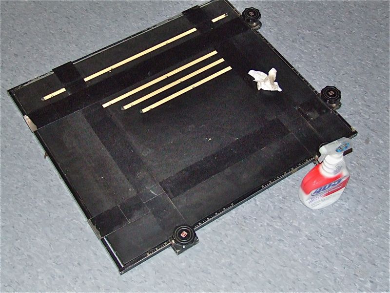

So, I disassembled the easel for a complete overhaul and rebuild.
ic-racer
ic-racer
Feb 25, 2007
16,477
USA
The metal tabs on the edges of the board that keep the frame up off the baseboard were missing, causing the blades to rest directly on the baseboard. I fabricated a new one from a bracket. The pictures show the one original in silver and the one I made in black:
ic-racer
ic-racer
Feb 25, 2007
16,477
USA
The bottom of the easel is particle board covered with a vinyl/aluminum cover. This was coming loose at the corners. I tried gluing it but that did not hold. I used some flat-head screws to hold it down:
ic-racer
ic-racer
Feb 25, 2007
16,477
USA
The rollers were soaked in Naptha, then painted and re-greased with white grease. The blades were cleaned, sanded and re-painted. My local hardware store still carries SAE hardware and all the rusty screws, bolts and washers were replaced:

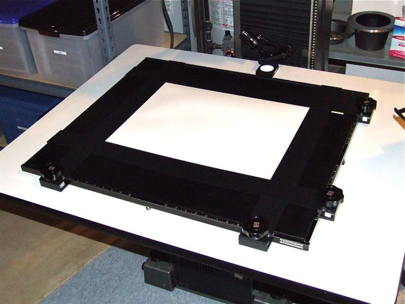

My wife surprisingly wondered why I was spending all weekend working on that 'junky thing' saying I should just have bought a new one at B&H. My concern is that B&H only sells the Beseler easel. I already have a Beseler 16x20 easel and it is one-eight of an inch off and is non-adjustable. This Saunders I just rebuilt has individual adjustable paper-stops for all the sizes.
ic-racer
ic-racer
Feb 25, 2007
16,477
USA
You may notice the 'old-fashioned' black surface. This actually forces you to use a viewing paper on the easel. So, in the end this has a much brighter viewing image than the image on the more popular yellow surfaced easels. I put rubber feet on the base of the easel so I can slide my viewing paper under the easel when not in use.

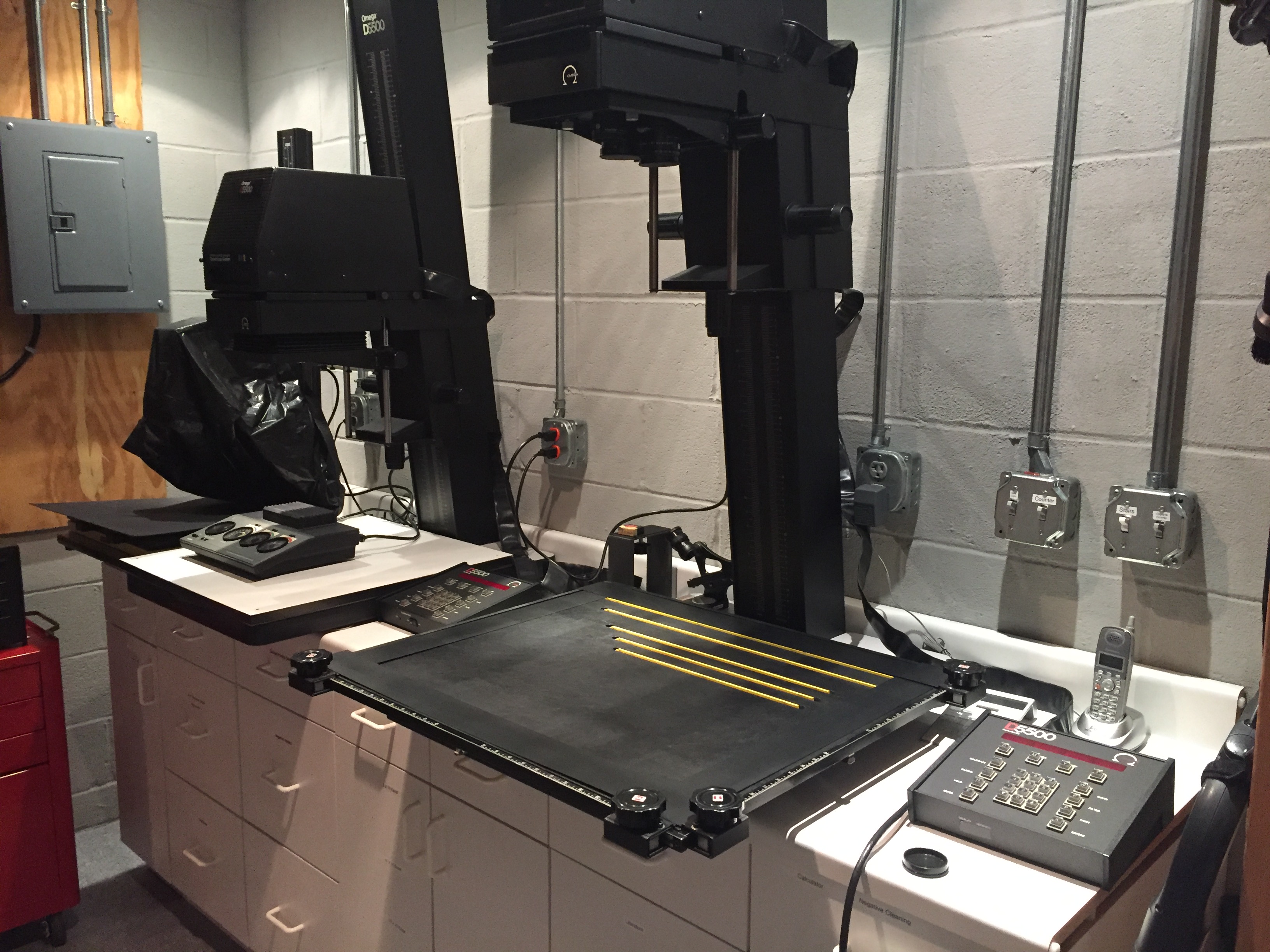

The 20x24 really is massive as seen here when it is used under a 4x5 enlarger.
