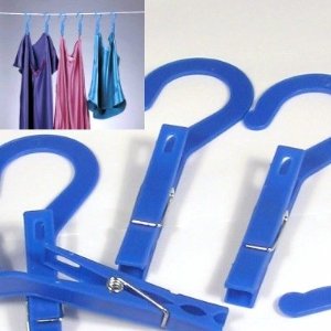

Try the "Dollar Store" or local equivalent for these:
+1 on the clothespins.
+2 on the clothespins.
