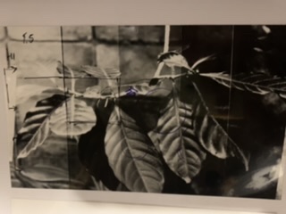

People, what marker is on the market for writing, I think the best is white, does anyone have experience. thanks for your comments.
Gente, que tipo de marcador, recomiendan para hacer marcas de esquidado y quemado en impresiones oscuras (zonaIII)
para las altas luces el color negro es una solución, para las zonas oscuras debe ser un blanco o amarillo? y que marca y modelo? recomiendan.
gracias

In the dark areas I need to make notes, the pencils or markers in my neighbourhood are not suitable.

If you have a home printer that serves as a photocopier, you can copy your work print on to copy paper, and then mark that up.
Otherwise, the answer may depend on which paper you are using. Particularly whether it is RC or fibre based.

Ballpoint
Pencil
Anything sharp
Indelible marker
Basically anything within a radius of 2m from where I'm standing that will leave a legible imprint when I need it.
Although that's probably not the desired answer. Let's see. I think the best, and in fact only acceptable device for this is the Faber Castell TG1-S provided the 0.6mm tip is used. Although it's on the cheap side.
Or just use any old permanent marker and find an appropriate spot to write on the test strip where it's easy to read. Plus, even in dark areas you can fairly easily read the writing if you slant the paper a bit against the light so you can see the ink shine.

Four dark areas I would consider a white or silver, laquer marker.
(Over here this would be paint markers of the series 750 and 780 from Edding.)

Grease pencils/china markers work great, but it is important to keep the written on prints away from negatives, because they can "shed" grease pencil, and once the residue gets on a negative ....
The OP is referring to writing on the print, keep things clean.....always.
Me too - but the grease pencil material can transfer from print to other surfaces.

If you look at photos of contact prints made by almost any famous photographer, yellow, red or white grease pencil/wax crayon seem to be the accepted norm to identify the killer shots and indicate any cropping. It always seemed an odd choice to me, for the reasons already stated by others. Personally I find a (black) Sharpie stands out pretty clearly against all tones, even the deep shadows, and adequate for contact prints. For dodging/burning notes I prefer to make a little pencil sketch.

So, on the likes of a RC gloss surface what markers can be used to give what I think is the OP's desire, namely to make what may be a complicated D&B map on the print surface, some of which might be black areas that is (a) easily seen and (b) quickly, if not almost instantly is absorbed by the surface without danger of smearing if touched?
Some of the suggested methods to do the above may be fine but I was not sure if all such methods addressed the problem of the RC surface. Clearly no problem with a scan of the print which is then printed on paper but I don't think that this was what the OP was asking about
He appears to want to write on the RC surface

collected a little bit of everyone,
Wax crayon option
market markers
specialised markers such as eddging 750
one does not escape from the design on paper and make the map dodging and burning.
thank you very much
It's not really grease in the pencil, it's a soft wax. If someone is sloppy and gets it on things not intended, they shouldn't have a DR.
