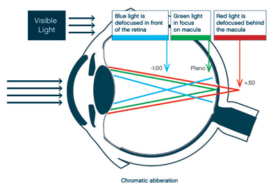

I have cameras like that (the numbers don't appear to be at the same focal point as the focus screen). My theory was that the simple viewfinder optics are not flat field. One might need a viewfinder with six elements for a perfectly corrected field.
The eyepiece must be flat field. Otherwise there at least would be unsharp corners at the groundglass image.
True. On second thought it may be the human eye's horrible chromatic aberration. My worst camera with this issue is Rolleiflex 3003 with LED readout. The red light is horribly out of focus in my eye.
