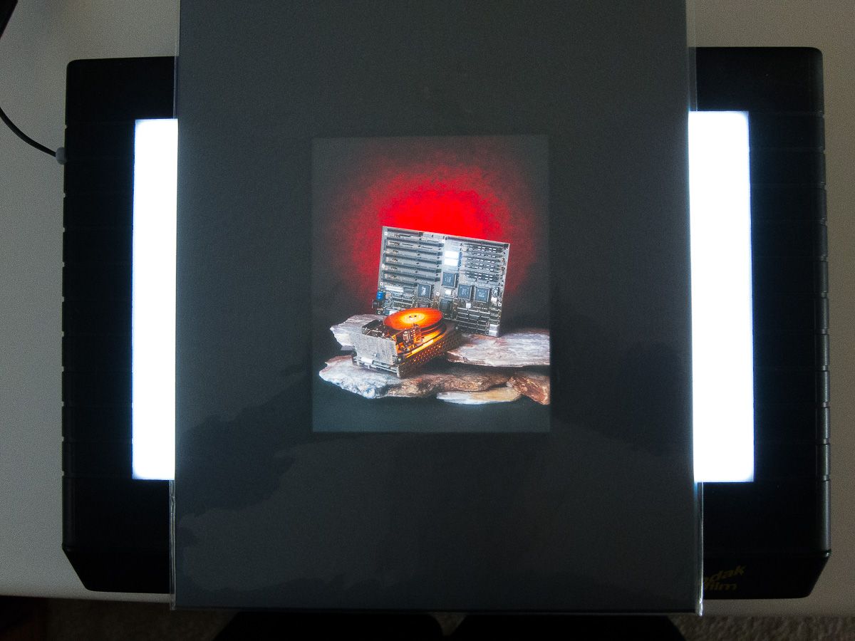

Slide mounts were previously intended to be put into slide projectors, and no one made a projector (apart from the Beseler Slide King) which could project more than 6x7 frame size. At one time 25 years ago, the Light Impressions company made presentation matte products intended to permit professionals to present 645, 6x6, up to 4x5 transparencies to clients for viewing on a light table with a loupe yet protecting the matted transparency in an polyethelene sleeve. Here is a photo I just took of such a matted 4x5 transparency on a light table.
Unfortunately Light Impressions no longer offers such products, since the world has so largely turned its back to film products even for professional purposes.
