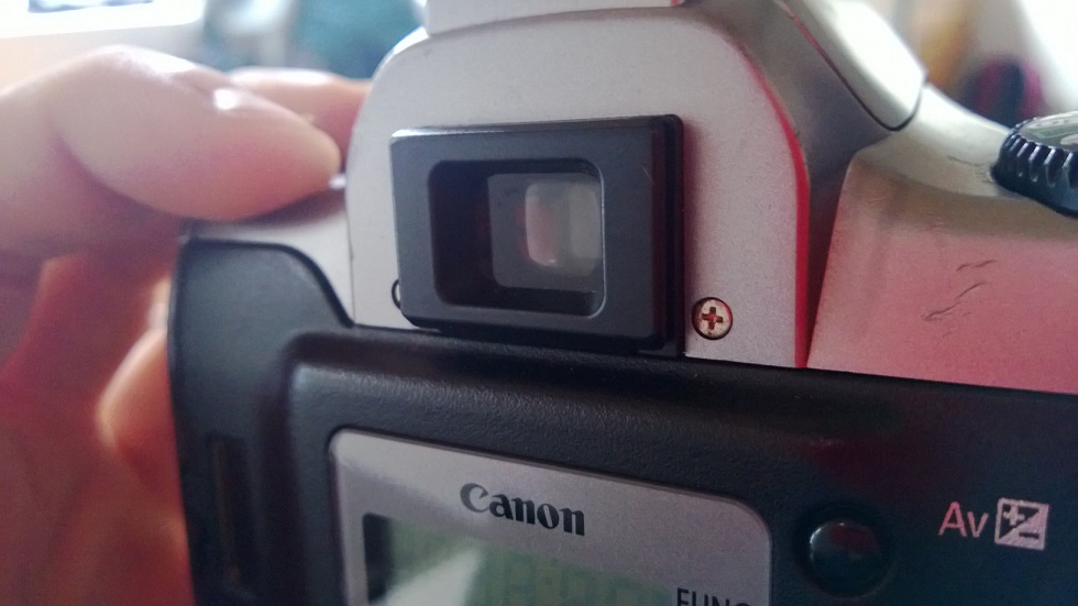

Hello all,
I have a Canon Rebel K2 that I've used for about 5 years which was an amazing $14 deal, but I've always been plagued with the crummy viewfinder on it:
Is there anything out there that can magnify the viewfinder's image and is actually practical? I do a lot of street photography, so intuitive is important. I've only seen one item made by SeaGull that looks like a big loupe sitting sideways on the viewfinder.
It's come to the point where I'm at a crossroads, the K2 is probably one of my favorite 35mm SLRs because of everything it can do, but this viewfinder problem is "tearing me apart lisa!" (reference from The Room)
I would love to use an older style metal SLR, and have owned many, but you can't rent the lenses anywhere and there isn't any Auto Focus.
Any tips on magnifying the viewfinder would be greatly appreciated!

I think it might be easier and cheaper to buy an EOS camera with a larger viewfinder. This week I bought a EOS 5 (or A2e) for less than £15.00 including postage.

I use the Olympus Varimagni Finder on my EOS1 (and various others) and may fit your model.
I don't know why you would use it with af lenses?

Hmm well, I was just trying to find something to modify what I feel like is the best camera in my hands. I like it more than most of the other EOS style cameras because it's smaller.
The periscope there is super fancy and nice, but way to bulky for me. I wonder if they make a different model?
I basically want the bigger screen because it's easier to take in the color and power of the potential picture. Focusing manually is also easier. To sum all that up, it's just easier to shoot with a better view.

There are straight magnifiers too but again these only magnify the center portion.
Basically vfs are divided between small or large magnification to accomodate people who wear eyeglasses or those who don't. For instance, the EOS1V has a magnification of .72 compared to the Pentax MX of .97. The near lifesize view of the MX is significant but of course not great for folks who wear glasses.
The Pentax LX has interchangeable viewfinders and screens that can offer huge bright views.

If you want good and cheap, the Elan IIe can be had for $25. Even better would be the Elan 7, currently going for about $60. Better yet would be the Elan 7N, for about $100. The Elans are light and extremely quiet.
The Rebel series are cursed with pentamirrors, except for the first two or three models. You can check the Canon Camera Museum for specifics. Pentamirrors are smaller and darker than pentaprisms.
There is a viewfinder extension that fits the K2 that you might want to have a look at. I had one once, though I wasn't entirely satisfied with it and haven't used it more than a few times.
I can see why as it reduces the already tiny viewfinder further by 30%!
The EPE-EX15 Eyepiece Extender for Select Canon Cameras from Vello extends the eyepiece 5/8" (15 mm) from the camera body and reduces the viewfinder's magnification by 30%. Reducing the magnification makes it easier for eyeglass users

I wear glasses and use that eyepiece extender without the optics. I tried it first with the optics and hated the view but liked the space for my big nose, so I pulled the optics out and now love it compared to having the viewfinder right on the body. I use a Minolta right angle finder for most of my SLR work now, but if I need to go light/small, I'll use the EX15.

I use an eyecup to hold a piece cut from an eyeglass lens. It should hold a magnifying lens as well. There is a standard magnifying lens made for the Olympus Evolt cameras. It slips right over the eyepiece.
