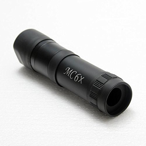

For MY photography, the separate loupe works perfectly. I was given one when I bought my camera, it looks like these:
It is just tall enough I can place it on the glass without removing the waist level finder, I still have the shade and framing from the waist level finder, and i also have the 2.5x loupe handy which I can use to focus while still seeing the whole frame. It allows me to work fast.
